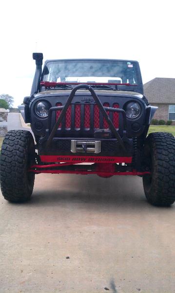

Originally Posted by PartySnake
leave them on your jeep and use painters tape to make a cut line. Measure various parts from the metal fender to your cut line so you can make both sides even. I used a dremel with their little diamond cutoff wheel and they turned out nice. Just dont go to extreme because once its off its not going back on!
U mean extreme like this lol. I Lo e them tho
