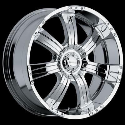

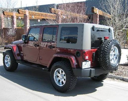

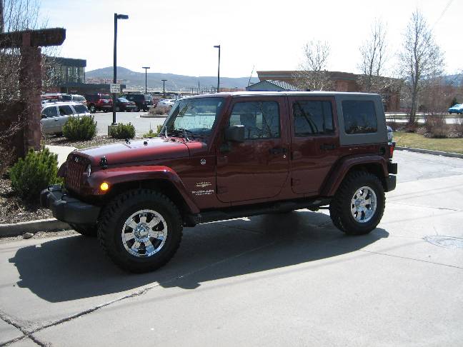

This combo works very well. I had BFG 285/65/18 on the stock rims and they rubbed. It also rode like a tank. I did a lot of research and decided on cooper STT 285/70/17 with incubus poltergeist rims. Looking at all the forums I could find on tires it came down to the toyo mt's or the STT's. Both seem to have very good reviews but the coopers are cheaper and they seem to run a bit narrower which prevented any rubbing issues. I can't believe how good they actually ride. Just as good as the stock Desert Dullers. Only a slight hum at highway speeds...plus they look great! I haven't taken it off road yet so I can't say for sure the tires won't rub the wheel-well, ill give ya an update soon.
1st pic=stock
2nd-3rd pic=finished project
1st pic=stock

Offset
This came from the incubus web site...hope it helps.
Wheel Wheel Cap Center Off BackNumberSizePCDCodeBoreSet Side
501 680 545 -06 16 x 8.0 5 x 114.3 4 83.7 -06 4.26"
501 680 548 -06 16 x 8.0 5 x 120.65 4 83.7 -06 4.26"
501 680 550 -06 16 x 8.0 5 x 127 4 83.7 -06 4.26"
501 680 553 -06 16 x 8.0 5 x 135 2 87.0 -06 4.26"
501 680 555 -06 16 x 8.0 5 x 139.7 1 107.95 -06 4.26"
501 680 655 -06 16 x 8.0 6 x 139.7 1 107.95 -06 4.26"
501 780 545 +00 17 x 8.0 5 x 114.3 4 83.7 +00 4.50"
501 780 548 +00 17 x 8.0 5 x 120.65 4 83.7 +00 4.50"
501 780 550 +00 17 x 8.0 5 x 127 4 83.7 +00 4.50"
501 780 553 +00 17 x 8.0 5 X 135 2 87.0 +00 4.50"
501 780 555 +00 17 x 8.0 5 x 139.7 1 107.95 +00 4.50"
501 780 650 +22 17 x 8.0 6 x 127 2 78.1 +22 5.37"
501 780 653 +22 17 x 8.0 6 x 135 2 87.0 +22 5.37"
501 780 655 +00 17 x 8.0 6 x 139.7 1 107.95 +00 4.50"
501 780 655 +22 17 x 8.0 6 x 139.7 1 107.95 +22 5.37"
The text format sucks but the offset for 17x8 is +00.
