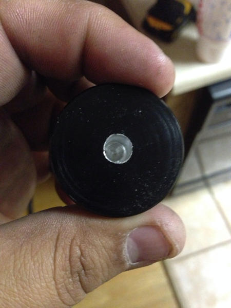

On my light bar what I did was I bought the security nuts with key from Carolina metal masters and fabricated it accept a 5/16" bolt.

I drilled out the nut and tapped it. Took me a whole 30 minutes to do both.

After I drilled out the end cap for the 5/16" bolt this is what I came up with.
