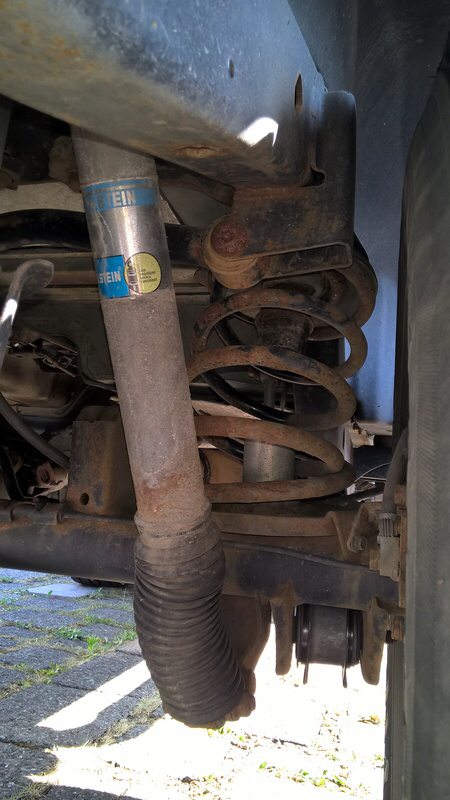

Really like bilsteins however if your area ever has snow the shock casing can get rust on it because it is not aluminum. I rode those before my fox shocks and they were great and really smooth. Here is an example of what salt will do to them however

also have heard a lot of good things about these shocks and will not have the issues described with the bilsteins
