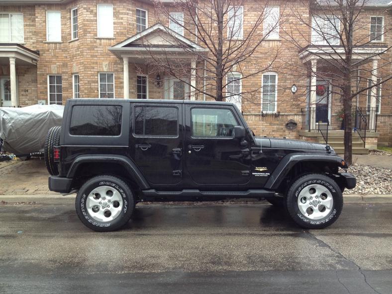

A pic below of my new JKU with plans for paint matching the bumper inserts and wheels and some larger tires in the near future. Likely will tint the front windows also and looking forward to warmer weather so I can get my NX Soft Top in place
