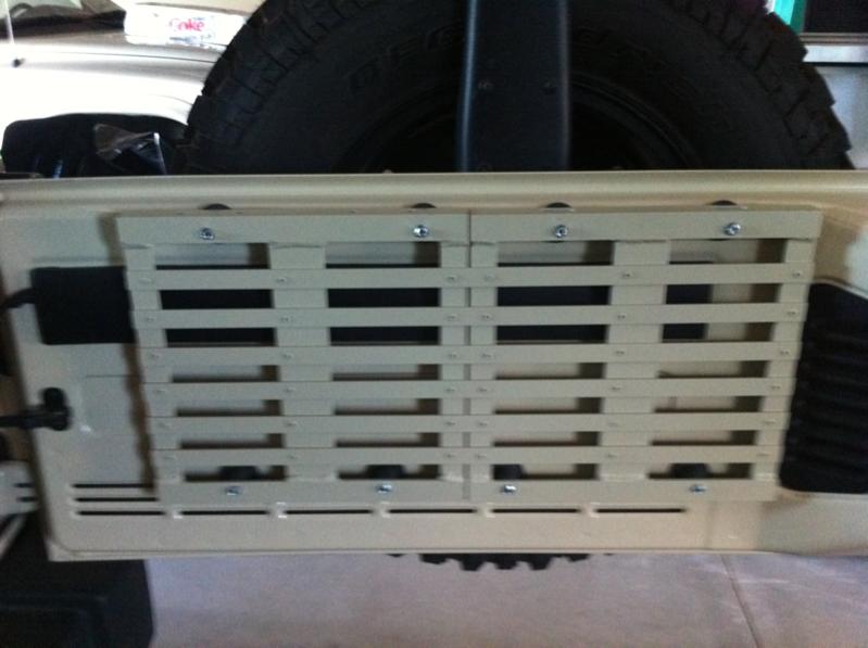

Two surplus ammo racks with straps removed. I used rivets to attach 1/8 inch X 3/4 inch aluminum from HD. Painted with fossil to match. Attached the rack with #12 2in sheet metal screws through 5/16 in rubber bumpers. I'm in it about $75.

Sweet idea. Where did you find the rack?

It's actually two racks. Got them at the local army navy for $20 ea. I have scene them online for $25. I think they hold two .50 cal ammo cans each.

Looks good, now you have more room to hang all the stuff you find yourself using when you have a jeep

Thanks, just waiting for a couple Molle pouches to finish it off.
