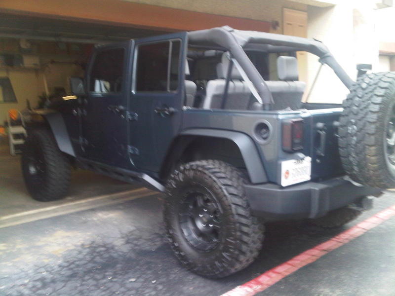

2.5" lift is perfect with 35's and cut fenders I think. 2.5" will work ok with normal fenders but it may rub at full flex (I can't say from experience)

Some may say you don't need them... but get adjustable lower control arms and an adjustable tracbar with your lift even with 2.5" imo Before I had them my jeep drove horrible on the freeway. Now its back to stock

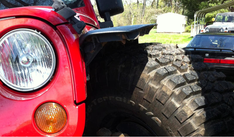

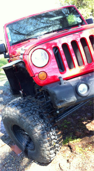

I run the 2.5 Teraflex with their 9550 shocks with 35 KM2s with trimmed fenders I choose not to use their extended bumpstops. As you can see flexes well and at full pressure there is slight rub in the rear. Don't understand all the hype over trackbars and LCAs mine drives just fine and tracks straight. Can let my hand off the wheel at highway speed and not worry about drifting across lanes.
