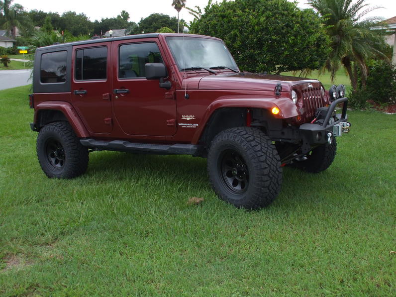

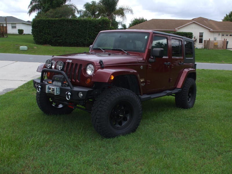

Unless you are going with 33" or bigger tires, you really don't need a lift.
That said, I have a 4" Rancho Sport Lift with RS9000XL adjustable shocks on my 2010 JK Unlimited Sahara. I am extremely pleased with the ride and handling.
If I was to do it over again today, I would go with their 3" with the same shocks. At the time I got my 4" the 3" wasn't available.
Rancho 3" Sport System for 07-13 Jeep® Wrangler & Wrangler Unlimited JK - Quadratec
Reasons for 3":
1) down travel is the same as the 4".
2) less stress on front drive shaft.
3) front track bar relocation bracket and control arm brackets not needed (simpler install with adjustable track bar).
4) uses standard pitman arm (less stress on steering box).
5) inch shorter means better rollover resistance.
6) fits in garage without taking off roof rack.
Except for tires and wheels with proper back spacing. Everything you will need is included.
Which ever lift you decide on, be sure to read the installation manual before buying so there won't be any surprises later:
http://gorancho.com/assets/instructi...Revision_A.pdf
