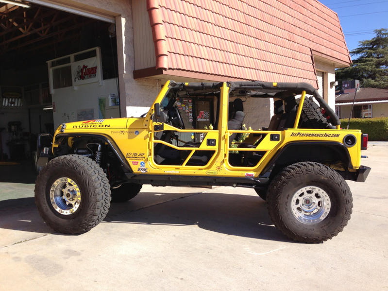

Just consider what it takes to run 40s without breaking parts: 40s need at least a 5 on 5.5 bolt pattern, otherwise you bend or break wheel studs. The stock front axle will bend the tube and/or bend the Cs. A minimum of 5.38 gears. Brake mods, big bore master, front rotors, dual piston calipers, etc. or they don't stop very well. And lastly, JK steering is bad enough with 35" tires, put a set of 40s on and good luck. Trust me, I've been through it. Do it right or stay with 37s or smaller.

Glad I could give you some insight. I have 40" MTRs now, but lots of $$ to do it
