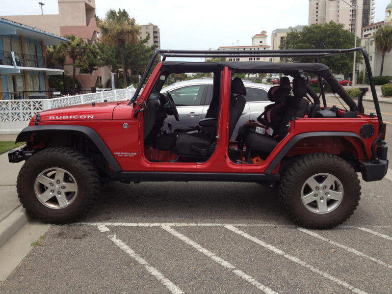

Teraflex makes two different leveling kits. Both are top notch. I actually think the performance kit rides better than my factory springs. Either way it'll stop that kicked in the behind look.Click image for larger version

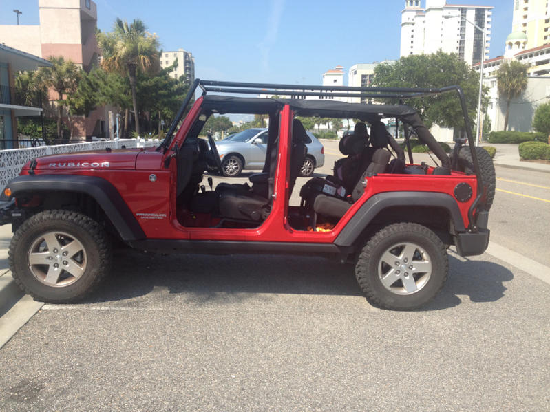

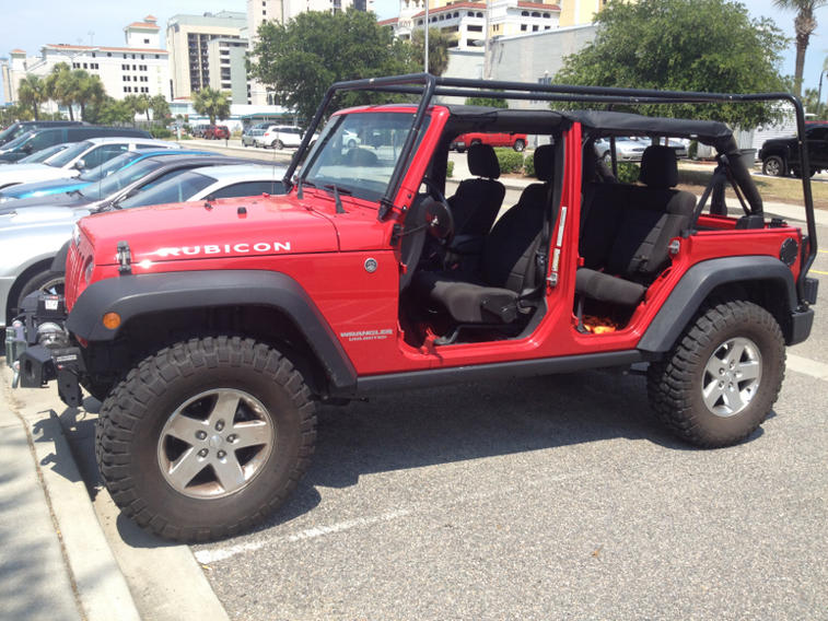

We are running the leveling kit not the 2.5" lift. The is no bump steer. It handles much like stock with a more aggressive stance. You can fit 35" tires on it with wheel spacers and it won't rub if you stay on the highway. I have 35" BFG KM2s on mine and they rubbed off road when disconnected. I trimmed the fenders and the rock rails. I haven't had anything rub yet.

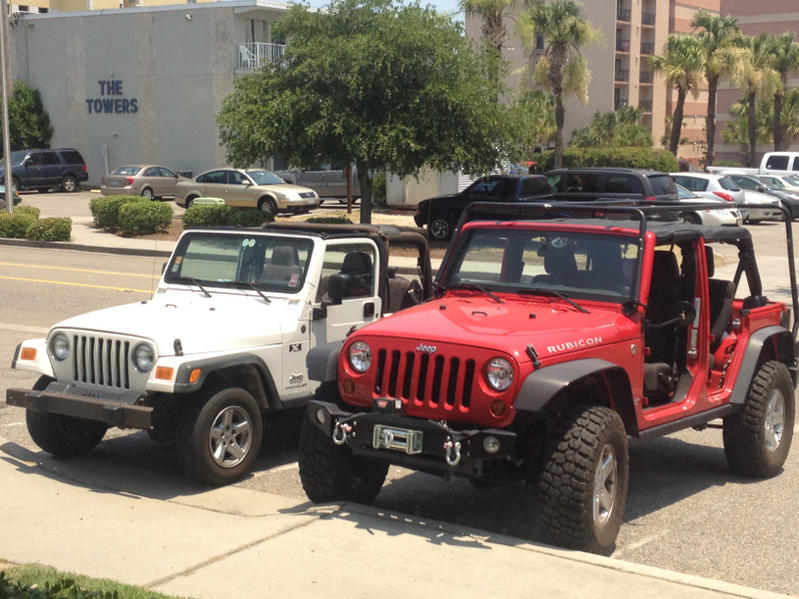

Here's a pic with the stock tires.

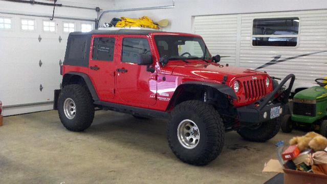

Here it is with 37s
