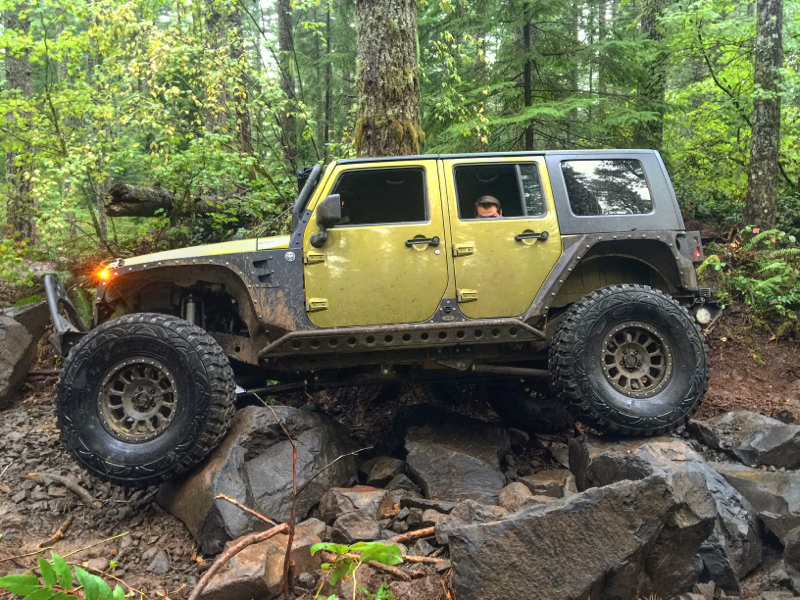

Hey guys was Offroading today flexed and broke my passenger wheel speed sensor in the front. Later on in the day I went to go flex on the passenger side climbing a side of a hill when I did that the flashing red thunder bolt symbol came on my dash.... No performance issues everything drives as normal just have that flashing thunderbolt going. Could the broken wheel speed sensor be the cause of this? Thanks for your help!
