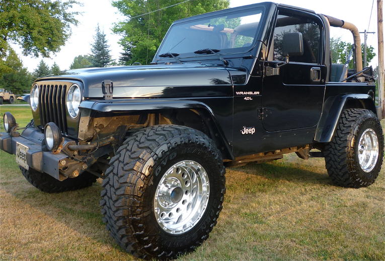

sure, with chopped fenders or other flat fender setup, you should be able to run 35's with little to no rubbing.
Yep, I agree! I did it to my 2000 TJ see:
35's don't rub at all after I choped the fenders, there are 1.25spacers installed also.
Still waiting for my JK to be shipped overseas, my lift an tires are already here! jus need the Jeep now!
Anyway hope this helps make up your mind.

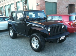

You can clear 35's no problem if you cut your fenders and a spacer. I am looking to only go up to 33's, so i do no need the lift. But, my local shop said to do a spacer lift if i went 35's. It was about a 2 hour job for me. I am getting better at it now that I have done a few of them. Check it out. I have a video to of more of the underside.
