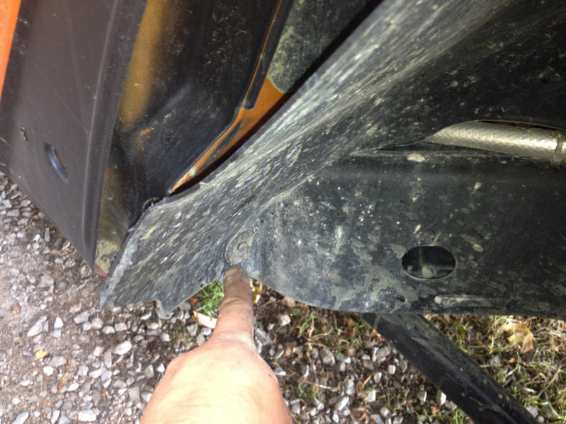

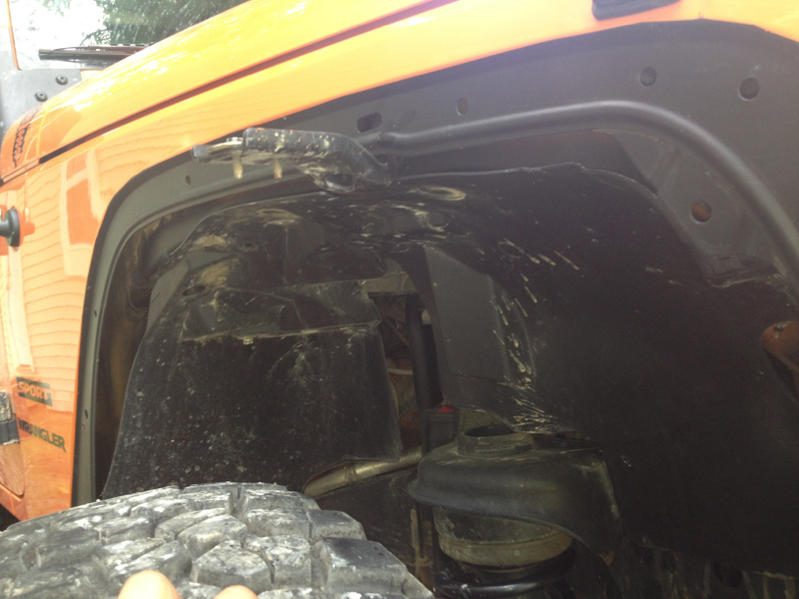

Originally Posted by spw4646
Anyone know of a write up for trimming the stock inner fender to work with flat flares? I don't want to ruin mine and I don't want the big gaping hole in the fender to the engine. Thanks and pics would def be a +
For the fronts, I just cut mine right along the line of the actual fender panel. I drilled a small hole and used a small bolt to secure the liner that the bottom rear of wheel well.
The rears serve no purpose other than holding and trapping mud. Rip those out and paint the wheel well black

Here ya go
