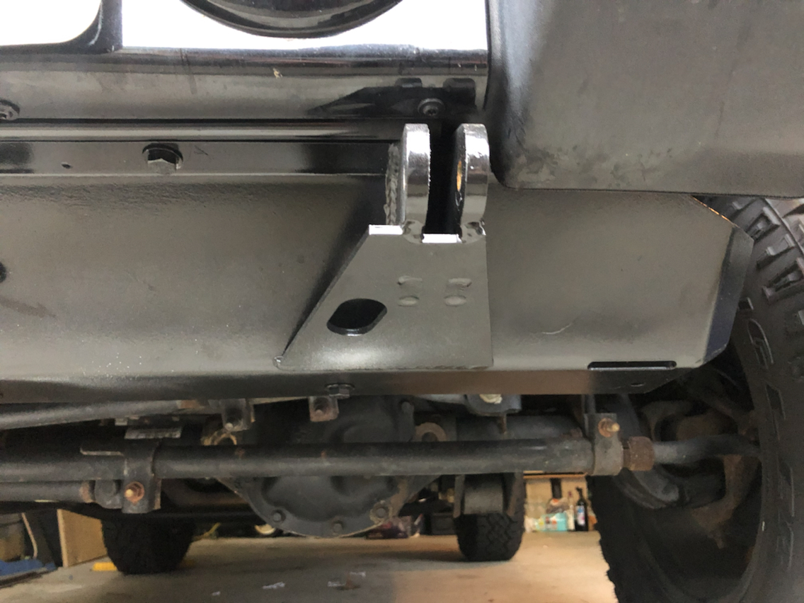

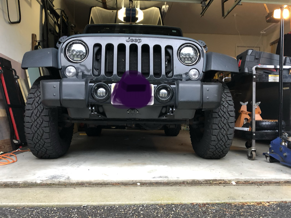

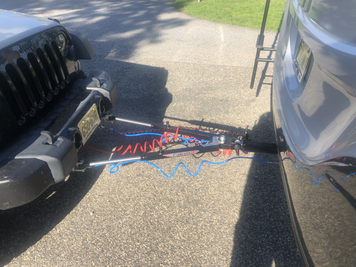

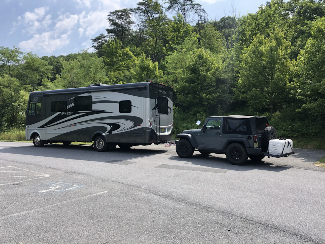

I set my 2014 jk up last year for towing behind my Newmar. I went with a Currie baseplate. I got lucky and found a used one for $180. It was an easy install. I also think it looks great. Paired with roadmaster tow bars, the thing towslike a dream. I also used a Hopkins wiring harness so the RV takes over control of the headlights. To top it off, I have a classic brake buddy for my braking system. I found most of my components used and did all the work myself, so ended up around the $1200 mark. There is tons of helpful information on the www.iRV2.com forum.
