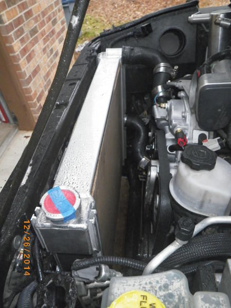

I finally went to install the flex-a-lite hemi radiator 52307 today and ran into considerable issues. The new radiator was a full two inches wider and of course one inch thicker due to three cores than the aluminum radiator supplied with the AEV kit. The radiator due to the increased width was up against the air box one side and wedged up against the AC / power steering cooler lines on the other side. The cooler was pushed to the side and bottom out of place due the radiators width and the hard lines to the cooler on the AC and the power steering would have to be altered to center the cooler where it needs to be.
The inlet and outlet nozzles on the flex-a-lite radiator were 1 1/4" closer together and lead to clearance issues with the outlet hose and the belt pulleys. The radiator can not be lowered down any more because it is up against the cross member on each end.
All in all a big thumbs down for Flex-a-lite in the design of this radiator. I have not been this aggravated in a long time with an install. So I just wasted a lot of time and money. Click image for larger version

Have you contacted them to verify that you didn't get the wrong one by accident? I wouldn't think a company like that would build something so far off for that application.
