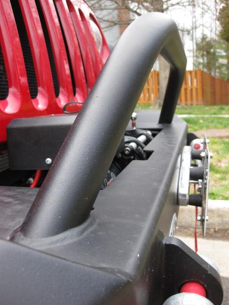

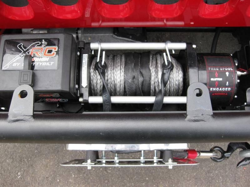

I have the LoD mid-width bumper and flipped my e-disco. It's a tight fit. Not the greatest pictures, but the best I have at the moment:
