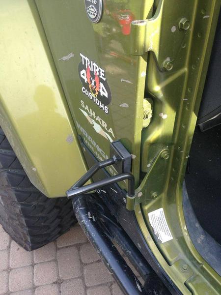

I think the guys at Tribe 4x4 in the DFW area are getting some of these made. Not sure on cost or anything, just thought I'd share.

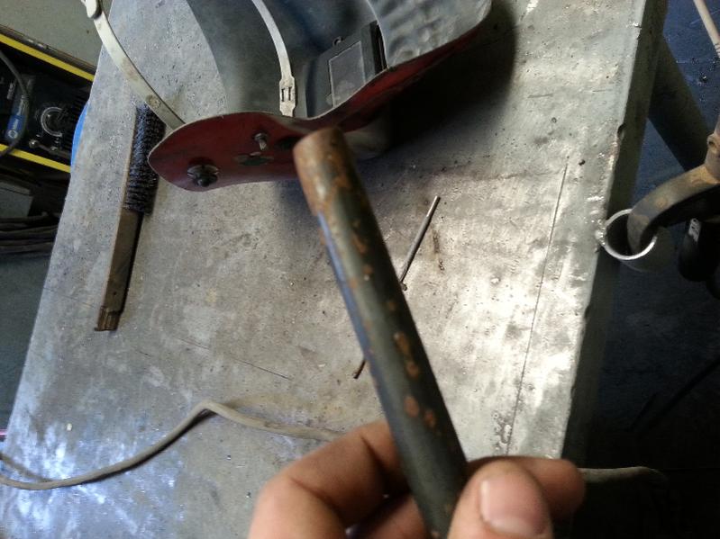

Cold roll

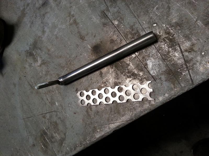

Notch cold roll

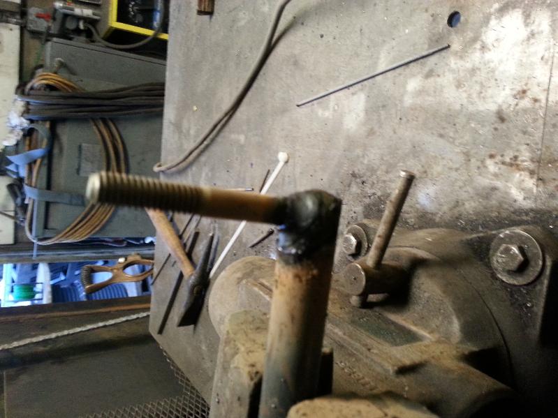

Set 5/16 bolt to weld

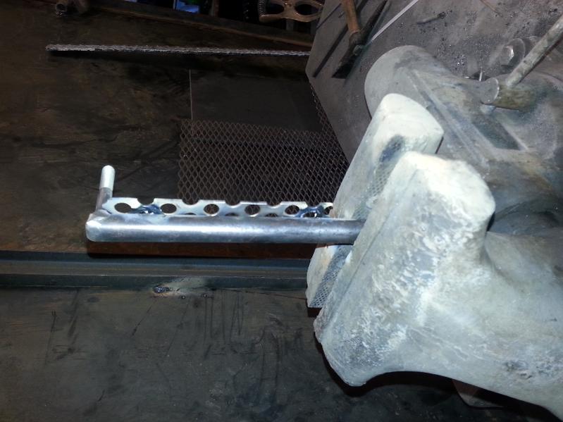

3/8" Perferated steel to match my grill insert
Weld on

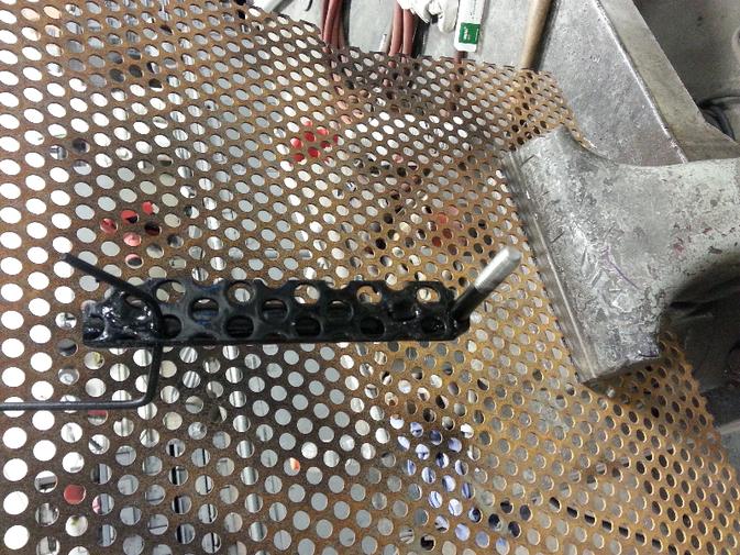

Plasti dip
