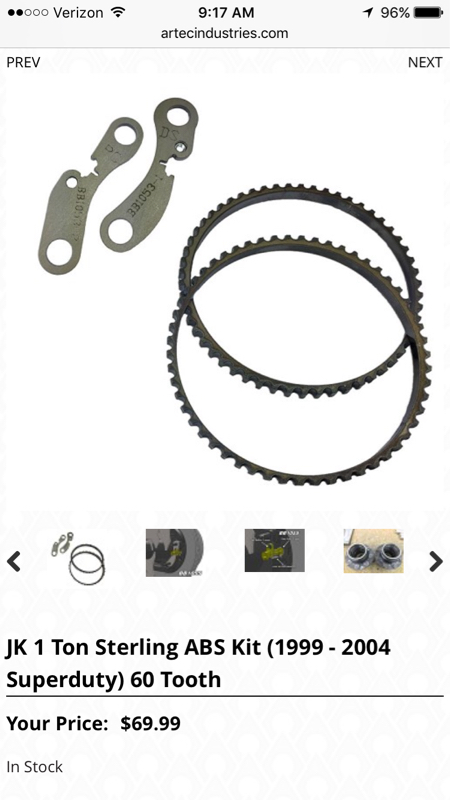

Being that he's got a 14 aren't there issues with the abs and sterling rear axles? I remember hearing something about no tone rings on the rear = limp mode on the 12+. Or has someone released a fix for the tone ring issue now? I think on the front Currie has a unit bearing with abs sensors but it's expensive.
OP, those super duty axles are awesome and would be easier to swap than the dodge ones because there is support and it's been done so info is out there, but this won't be a simple plug and play, weld up some brackets and go type of deal if you plan on having a clean install on a street driven rig. There will be a lot of nagging little details like fuel tank, abs, brake and master cylinder issues, parking brake, etc. Know what you are getting into cause you will have a lot more money and time into this swap than you expect, that's what everyone has said that has done this on a JK. Of course they have been swapped before I'm just trying to give you some friendly advice, just do your homework and read some of the build threads on JKO to get a heads up will make this much smoother.

Originally Posted by Biginboca
Being that he's got a 14 aren't there issues with the abs and sterling rear axles? I remember hearing something about no tone rings on the rear = limp mode on the 12+. Or has someone released a fix for the tone ring issue now? I think on the front Currie has a unit bearing with abs sensors but it's expensive. OP, those super duty axles are awesome and would be easier to swap than the dodge ones because there is support and it's been done so info is out there, but this won't be a simple plug and play, weld up some brackets and go type of deal if you plan on having a clean install on a street driven rig. There will be a lot of nagging little details like fuel tank, abs, brake and master cylinder issues, parking brake, etc. Know what you are getting into cause you will have a lot more money and time into this swap than you expect, that's what everyone has said that has done this on a JK. Of course they have been swapped before I'm just trying to give you some friendly advice, just do your homework and read some of the build threads on JKO to get a heads up will make this much smoother. I envy all you guys with SD axles. Such beef!
Here ya go
But I have my abs/esp disabled anyway. It's not very fun Offroad.
