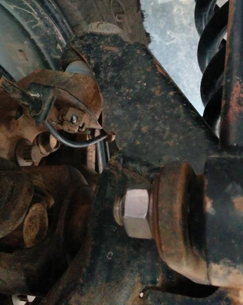

I did the same thing. Pull the cotter pin out of the upper ball joint, remove the nut from the ball joint stud, put the bracket on, reinstall and retorque the nut, install a new cotter pin. Minor nuisance.

Here's a clearer picture of how it goes.
Simple enough. Thanks.
On a related note I did get to top to break free but I cant get the bottom. I saw a video showing a method where you use two hammers to hit the lower end on both sides so it spreads the upper end of the taper and lets it drop free. Worked great on the top but the shape of the bottom doesnt allow for that method.
edit: for some odd reason I thought it was supposed to go above the outter "C" (or whatever its called) and not below.
I was trying to remove the whole thing.
This is what happens when you leave a project for a week and then resume it. You forget the little things! Thanks guys. All is now well.
