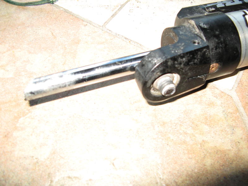

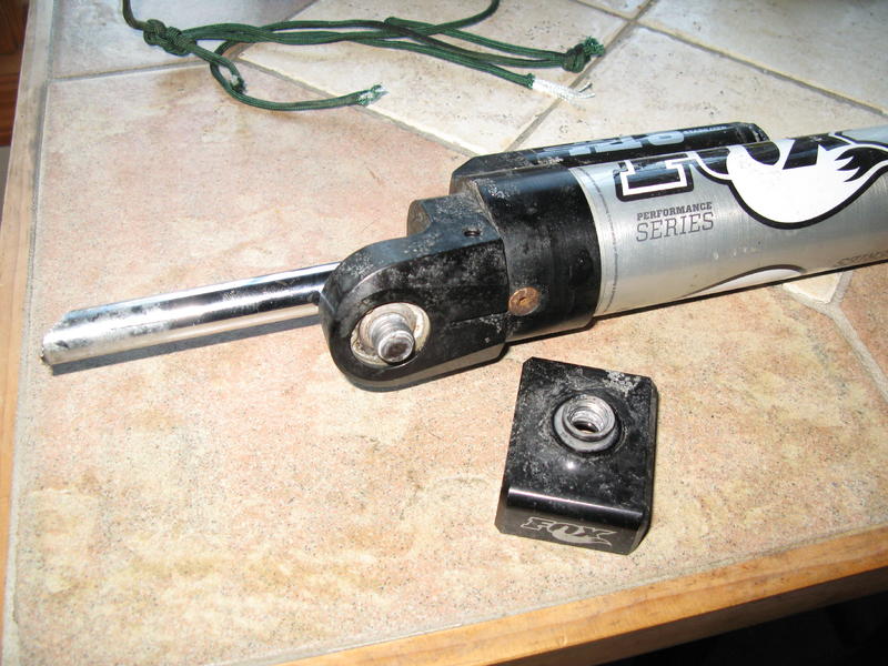

Any of you guys running the ATS Stabilizer should check your Tie Rod clamp. Mine took a crap today.
The factory installed bolt holding the bracket to the shock came loose sending my unit crashing to the ground. it got twisted under the Jeep and the mounting end snapped and the piston rod got chewed up.
Check your clamp. It should've been installed with red loctite from the factory.

I sent an email with pics to Fox. Also got in touch with Globex who did my lift. They are also gonna call Fox. See if I can get a new unit out of them.

Thanks for the heads up on the tie rod clamp. Although for the guys that have the shock body roll over, I don't see how that's possible unless you loosened the allen screw or didn't tighten it back up so it wouldn't move. Or maybe it just doesn't clamp down hard enough but I haven't seen any movement for the few months I've had it.

My clamp never budged either. It just came apart. 7 months with light offroad use.
