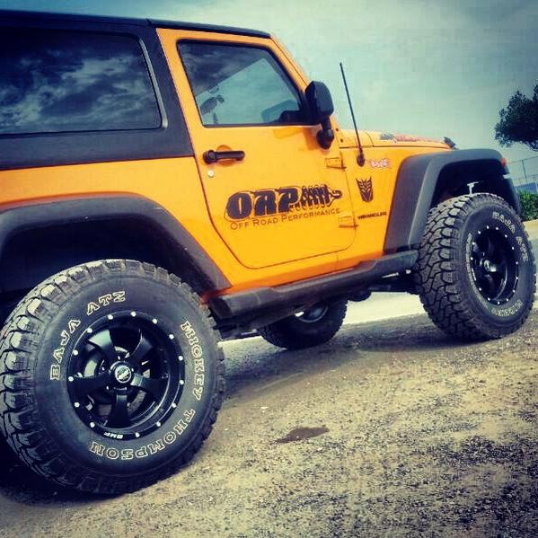

Howdy guys i have a jk 2012 ME w/ TeraFlex 3" and adjustable control arms and i wanna change the tf shocks so what is the best?! For smoother ride im 70% on road!
P.S: dont care about price.
