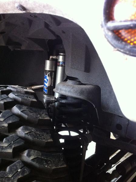

Originally Posted by PartySnake
I have had the teraflex valved fox shocks since May and can say they do make a difference blasting through the trails. However, they have been beatin and now the front has lost the nitrogen charge and needs to be rebuilt.
Do you see any external knocks or damage on the shock ?
They're tucked up pretty high, so I'd guess that the build of the shock was faulty, or a very rare case of a faulty shock.
I have yet to see a problem with a Fox shock which was properly built and installed.
Name:	Front Shock - Fox 005.jpg
