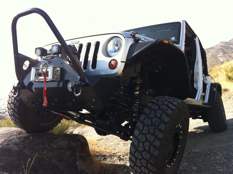

I changed out my rancho steering stabilizer for a fox 2.0. what relo bracket are you using. Mine broke the other night in cleghorn so I hade to drop it back to the stock location. Looking to buy a new bracket right away.Click image for larger version

I just received mine and I am ready to install. Did you install the shock with the body attached to the relocation bracket or the tie rod?

I attached the body to the tie rod, it wouldn't fit the other way.
