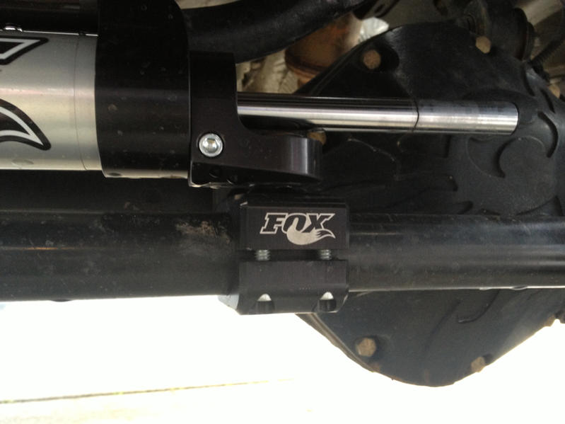

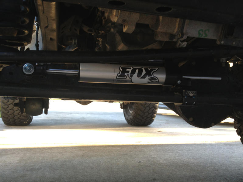

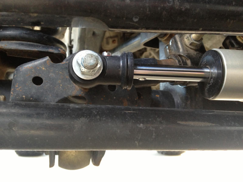

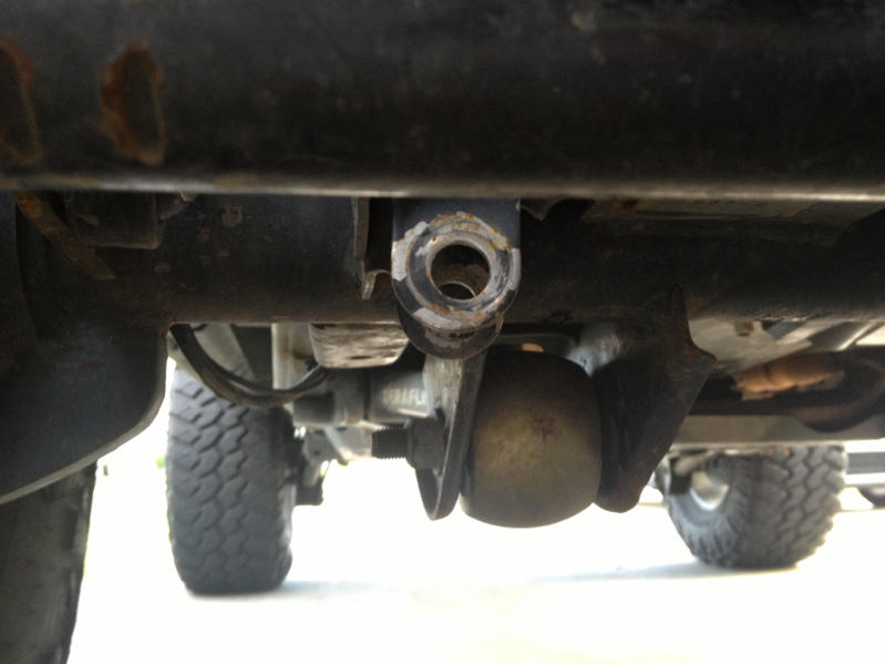

You need remove the lower track bar bolt and replace it with the provided bolt. Then either spread or cut off the tie rod mount bracket and mount the provided billet mount. I have attached some pics that will hopefully help. I know the instructions aren't really to good so let me know if you need anymore info or help.

THANKS!! that's what I did, and now its working. Thanks so much.
