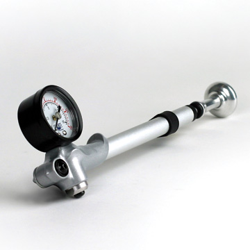

I used a high pressure air pump (I use it on the shocks on my mountain bike) to release some of the pressure. It worked perfectly, I let out about 40 psi.
