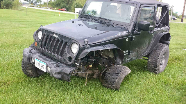

Actually, an aftermarket bumper does affect the crumple zone because the impact to one side of the front is spread to both zones in the frame, not just one side. Yes, the factory bumper has the steel plate in it, that spreads the impact also, but not as much as a aftermarket does.
This is a buddy's jeep after a 60 mph impact, I don't think there is any issue with the jk frame needing to be beefed up. Looks like it held up just fine to me.

This. Ladder frames will take a bump and a bash and won't total your rig. I've backed into rocks with WOT and have bent a 35 spline Dana 60 and moved my rockhard bumper with my 2 door and do not see any signs of a bent frame.
There are only a few places JK's frame can use a little bracing I have found. At the steering box because of deflection at the sector shaft. Lots of companies offer solutions here: JKS, Synergy, etc. Also the factory transfer case cross member is pretty flimsy so I rebuilt mine. But neither of these are full frame bracing or removing crumple zones.
If there was even a slight demand for full frame bracing on the JK companies would be marketing it by now since all it would be are 2 long pieces of U-shaped metal with notches that would cost a grand.
