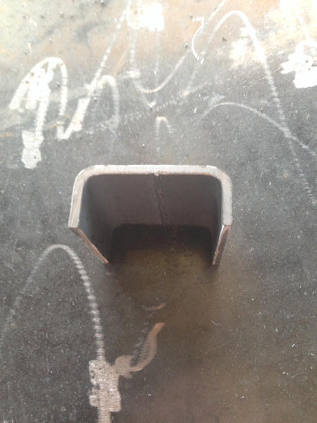

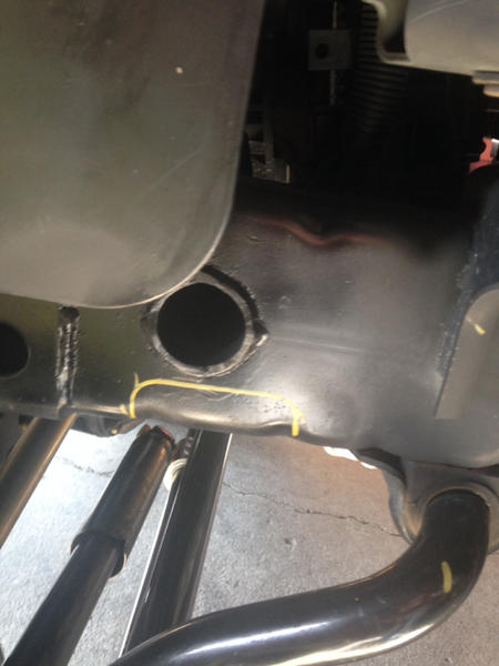

I should have left more overhang in the back and less in the front. It would allow the power steering line to tuck up above it better and I'm worried my swaybar might rub on plate like it did on the round tubes. Oh well, I ground it down a little - we'll see what happens.
ID:	611510   Click image for larger version
ID:	611511   Click image for larger version
Looks good !!!
Looks great! I definitely need to do this soon.
Just FYI the location you are notching is in the front crush zone of the frame. This is what those small notches in the frame are. Modifying this area may affect your airbag deployment timing in a crash.
