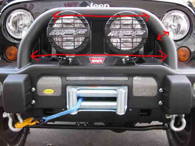

hey im wanting to know the dimensions in the pic.
1. the diameter of the tubing.
2. the widest width at the light tab height
3. the top width of the bar.

its to see about mounting an xmitter light bar. they sell clamps for tubing so i thought it would be cool mounted above the hoop. the other option is to mount it using the light tabs but need to now what width to get. if anyone has this setup please post.

1. 3"
2. 28" weld to weld, and 27" inside to inside tube at the height of light tabs.
3. 20" inside at the top where the tube starts to bend. 22" outside the tube where your line is drawn.
In addition the tube rises 9" from the top of the bumper to the bottom of the tube at the center.

thanks man thats perfect
