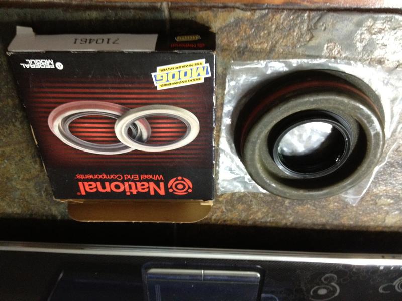

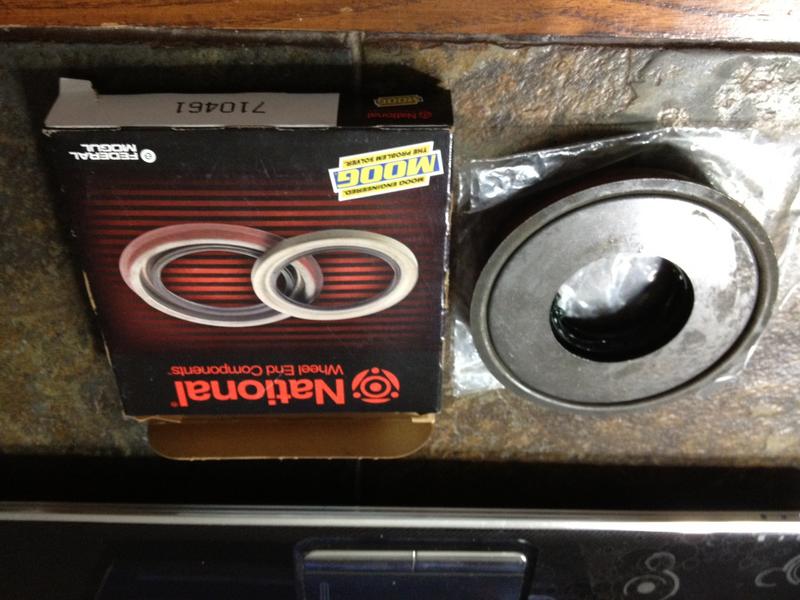

Ok so I go to Oreilly"s and this is the part they gave me, it is not even close. I took some pics of the seal and the rear of my axle where the seal is. I know when I took the D/S off and when to loosen the bolt it wasn't very tight, I torqued it to 160 ft lbs and used red lock-tite on it. I figured I would have a hard time getting the yoke off but it just slid right off. Could the yoke not being tight against the seal cause it to leak?

If I'm not mistaken its an internal seal
Old Mar 10, 2012 | 04:54 PM
jrylb73's Avatar
Posts: 204
From: Granby, MO
Great, so now I am going to have to wait till the Jeep dealership opens monday to get the part. So can this part be bought at a local auto parts store and if so does anyone have the part # for it?
