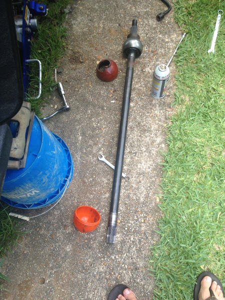

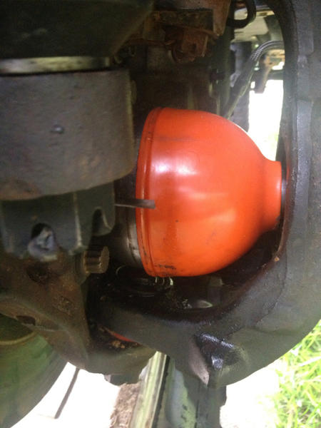

So I have a rubi 44 front axle with rcv shafts. Both RCV boots are getting tore up drivers one is chewed 360 degrees around and the other has a hole in it. I replaced the one with a hole today and left the other one because its still sealed. I am running 39 in Krawlers with only upper gussets and alloy ball joints. Could the C be flexing enough to cause it to hit the RCV boots even with though they aren't Dynatracs? Or maybe the BJ's not be seated all the way on the bottom set? There is a Gap between the BJ and the RCV boot and they look seated well. I was told they were replaced fairly recently before I bought the jeep though and while I drove it from North Carolina to Alabama I havent put significant mileage on it.
On a side note, when I pulled the RCV shafts today I had dirt in my axle tubes and there was no outer seal at all. Is this normal. thoughts and ideas?

Originally Posted by GulfCoastJeeper
A few photos.
The hole in one
Attachment 470417
The ball joint seated?
Attachment 470418
Hard to tell from the pics, but, those RCV boots don't look like they're pushed on and seated all the way on the CV joint. Also, if you use the Synergy ball joints, they have a flush zerk fitting that won't rub.
Old Jul 2, 2013 | 07:35 PM
GulfCoastJeeper's Avatar
Posts: 580
Likes: 5
From: mobile,al
Yeah that boot wasn't seated all the way at the time. I posted it to show that it did appear to not be rubbing the ball joint on level ground. It's seated all the way now but apparently ill be pulling it to put in the synergys now....
