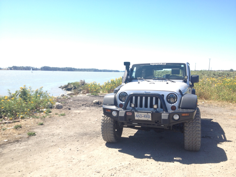

I have the arb front bumper and while its not a difficult installation there are more pieces to the arb than other bumpers I've done in the past ( side support brakets, liscence plate flip up braket, fog lamp brackets, wiring for the side marker lights). Don't let this scare you off from doing it yourself. It'll be about an afternoons work with a buddy's help .... You can do it alone but it's very awkward an a little heavy.

What do you think of it? I'm kind of tossing up between the arb and another one, they're very similar in function, appearance and price, so has really just come down to the arb name. Everything straight / fits nicely with it?

awesome, looks tough and very much at home. only problem I have with it is those orange markers, I'm going clear in the stock positions so the orange doesn't work so well for me, do you know if there are replacements available, and are they easy to get out once the bar is on?
edit: also interested the how you find it for light mounting / wiring, once the bars on i'll grab an spod and kick off with some light up front while I plan my next move
I don't have the orange markers hooked up right now... Looking for an led alternative. Light mounting / adjusting / wiring is all very easy with lots I access... The only thing you'll have difficulty with is that the grill no longer has space to fully come off ( there is room for it to come outward enough to switch out headlights)
