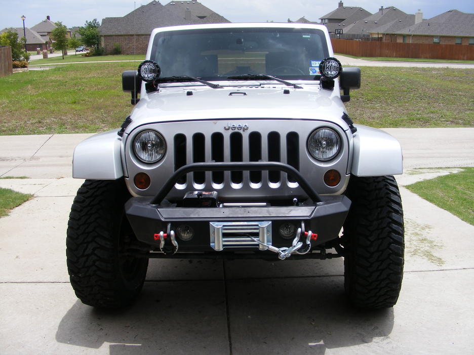

Do the bumper yourself. I just did mine yesterday. Took me all of 2 hours. I did my winch today, that maybe took 1.5 to 2 hours as well. You'll save a ton of $$$ doing it yourself. Here's the results of my 4 hours of work

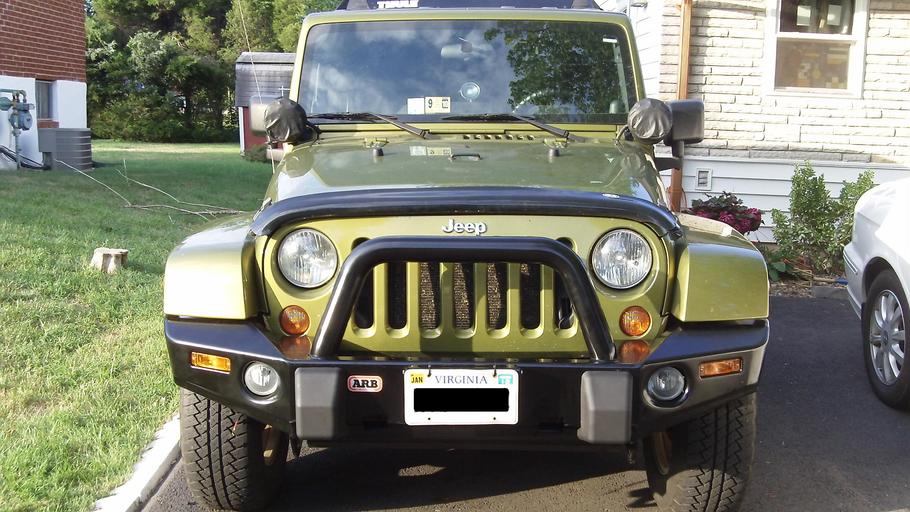

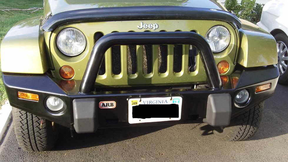

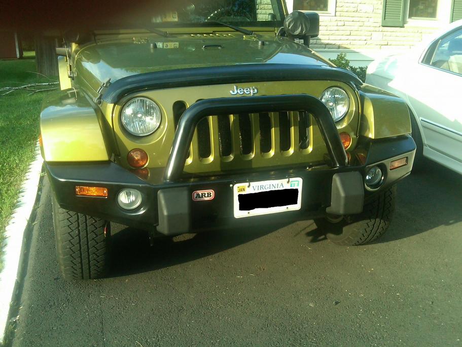

Alright the bumper is on! It took my and my friend about 4 hours. Talk about a pain in the ass!! Now I just need to wait for the winch to get here, which is on back order. Well here are a few pics of the finished product. Any questions just ask.
