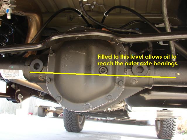

From what i've read you want the oil level to be at the yellow line shown in pic. for my rear riddler diff cover, i just stuck my pinky finger in there and see if i could touch any oil
