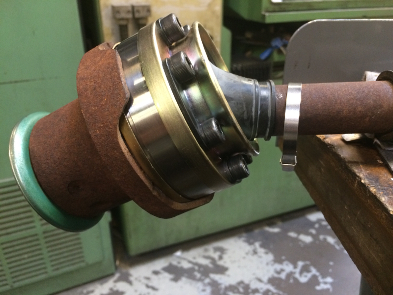

Absolutely. I just swapped a Rzeppa out on a stock rear with the TF joint.
EASY swap BIG difference in angle.
