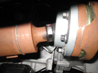

Just expanding on the vibration question. My rear angle is all set up even and ready to be replaced. If pinion angle is so critical in the rear to prevent vibration, what is different in the front. With my caster set at 6 degrees, the angle at the transfer case is much more severe than the rear and looks like it may actually fail first. If I were to dial back the castor to 4-5 degrees, I can't imagine it would improve the angle much? Can anyone weigh in about the looks of their front angle at the xfer case. Does it look the same as mine? Oh that doesn't sound right!
Attachment 15952
you know what, just finished my 3" lift, set caster at +5.5 via teraflex lowers and my ds looks about the same...I myself am curious to hear what others say

I think we are all in the same boat here. I installed my TF 3" 2-weeks ago along w/ full flex arm kit. I got a rear TF D/S the same time as the lift. I also had the same problem in the front end w/ the stock D/S and angle. So I got a TF front D/S, I am now at +1 Castor to get rid of the vibe. I think it is out of balance.... I think I am going to end up taking it to a local shop and have them re balance it.
