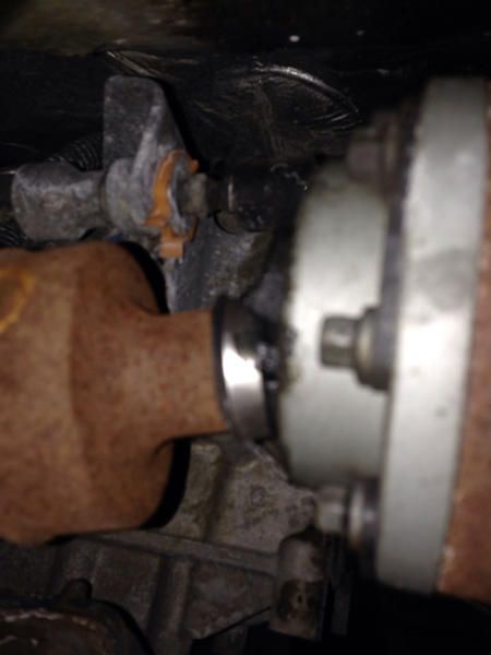

Jeep is a sahara with 3.5 Rubicon Express lift with about 20,000 miles with lift installed running 35's
Have been using 4wd more than usual due to alot of snow here within the past couple weeks.
Was in 4wd today and noticed a squeak from the front drivers side. Sounds like the u-joint in the front ds. Noise is only in 4wd.
My question is how often does everybody go through u-joints with that much lift? Should I consider a new driveshaft all together?

Curiousity got the best of me and I went out for another look and this is what I find. FML.
Lots of variables, some go in a few thousand miles, others are good for years. Flip of the coin.
Grab a cheap/free take-off from someone who has upgraded
Quadratec sells a rebuild kit.
Or since both of those options will just have you repairing or replacing again in the future, just go aftermarket.

If you haven't already, you can pull the DS and run around without it until you get the time/money to replace it.
