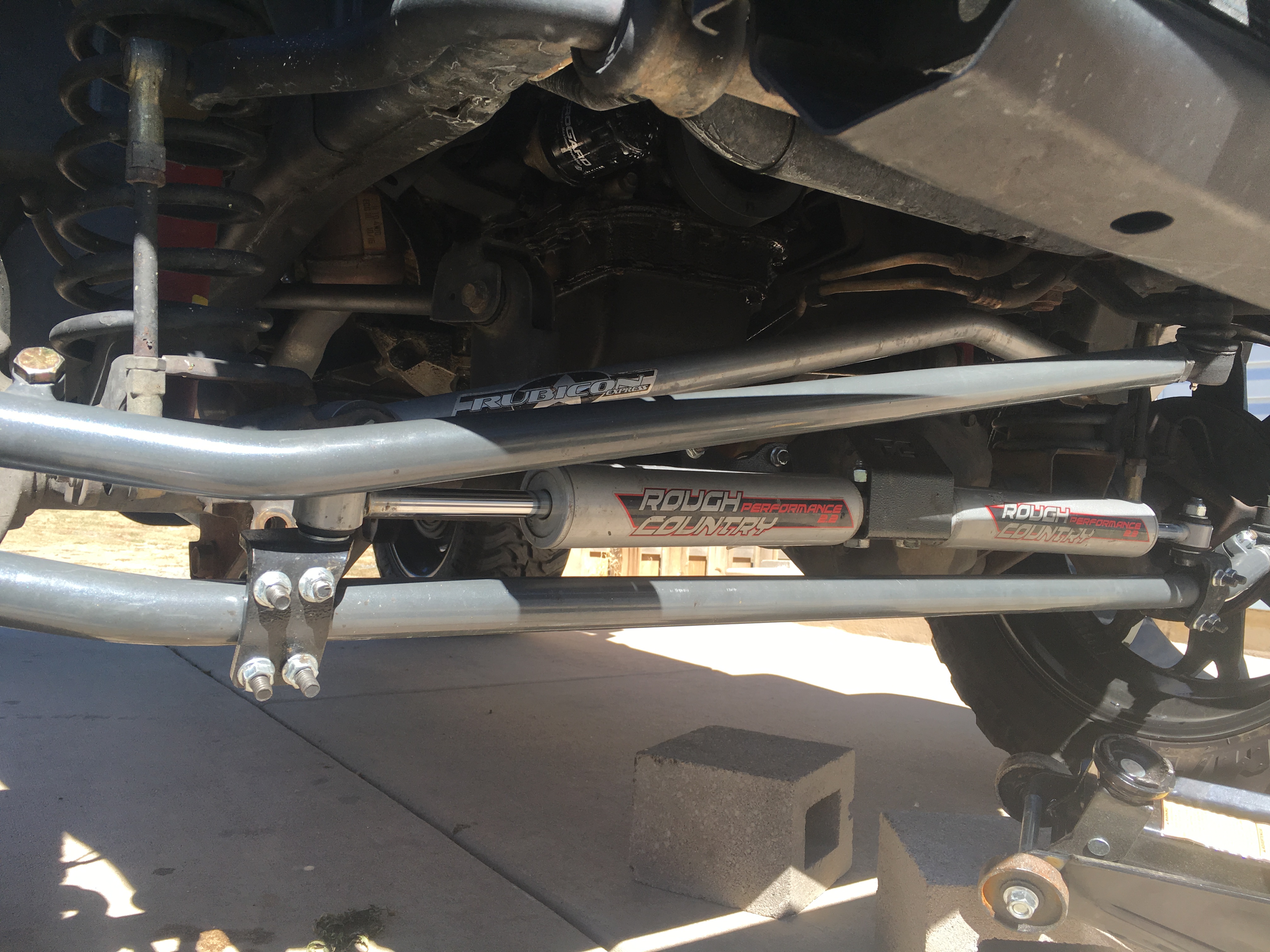

When you put the new Trackbar on did you put on a relocation bracket for the stabilizer and Trackbar. ?
Is your Trackbar and draglink parallel.???
Wobble general is caused by loose warn parts especially the Trackbar bushings.
Bumpsteer is caused by the Trackbar and draglink (steering link) not being parallel. Everything you hit a dip in the road the steering wheel will turn in your hand.

Dual stabilizers are pointless, you shouldn't need both. Your problem can come from multiple things and each one has to be diagnosed. You're steering wheel shouldnt uncenter unless you've stripped the neck on the drag link, allowing it to unthread or you haven't torqued it down tight enough to keep it from doing so. First off, check the torque on EVERY THING YOU SWAPPED. Any play in the tie rod or drag link can cause this issue. Check the balancing of your wheels/tires. Check the bushings in your control arms. Confirm you installed the ball joints correctly. And just so you know, most of these parts you're mixing and matching sometimes rely on other parts such as correction brackets to make sure the geometry in your suspension is correct. Your draglink and trackbar should be on the same angle or VERY close to avoid any irregularities in your steering. As for your alignment being off, that doesn't happen very easily. And quite honestly, it typically takes you disassembling your front end completely to require all of it to be set up again on a machine. In most cases you can take a front axle apart and put everything back in the front without the need of an alignment as long as nothing changed in the process. Start from the front and make your way to the back torquing everything to spec.

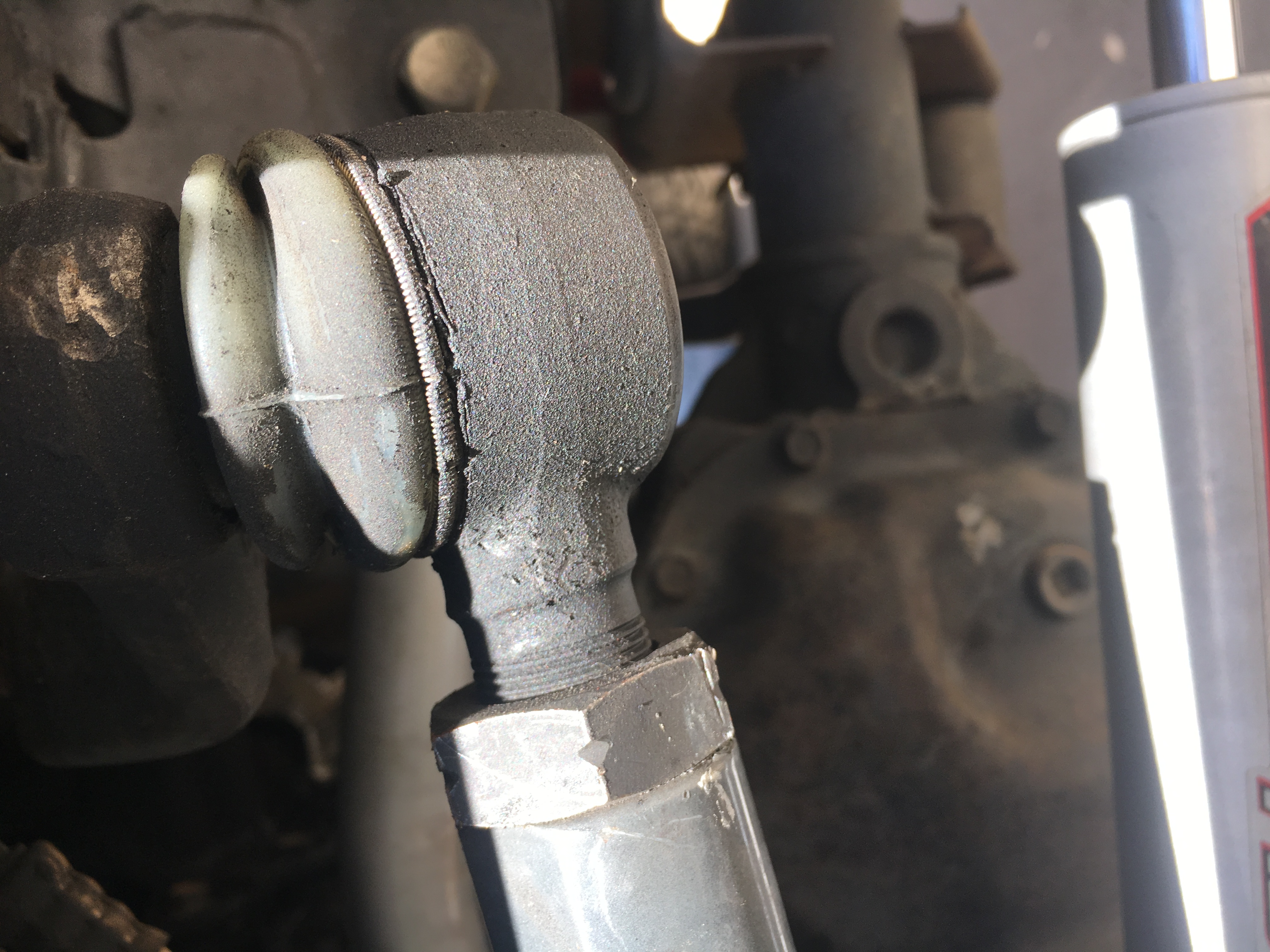

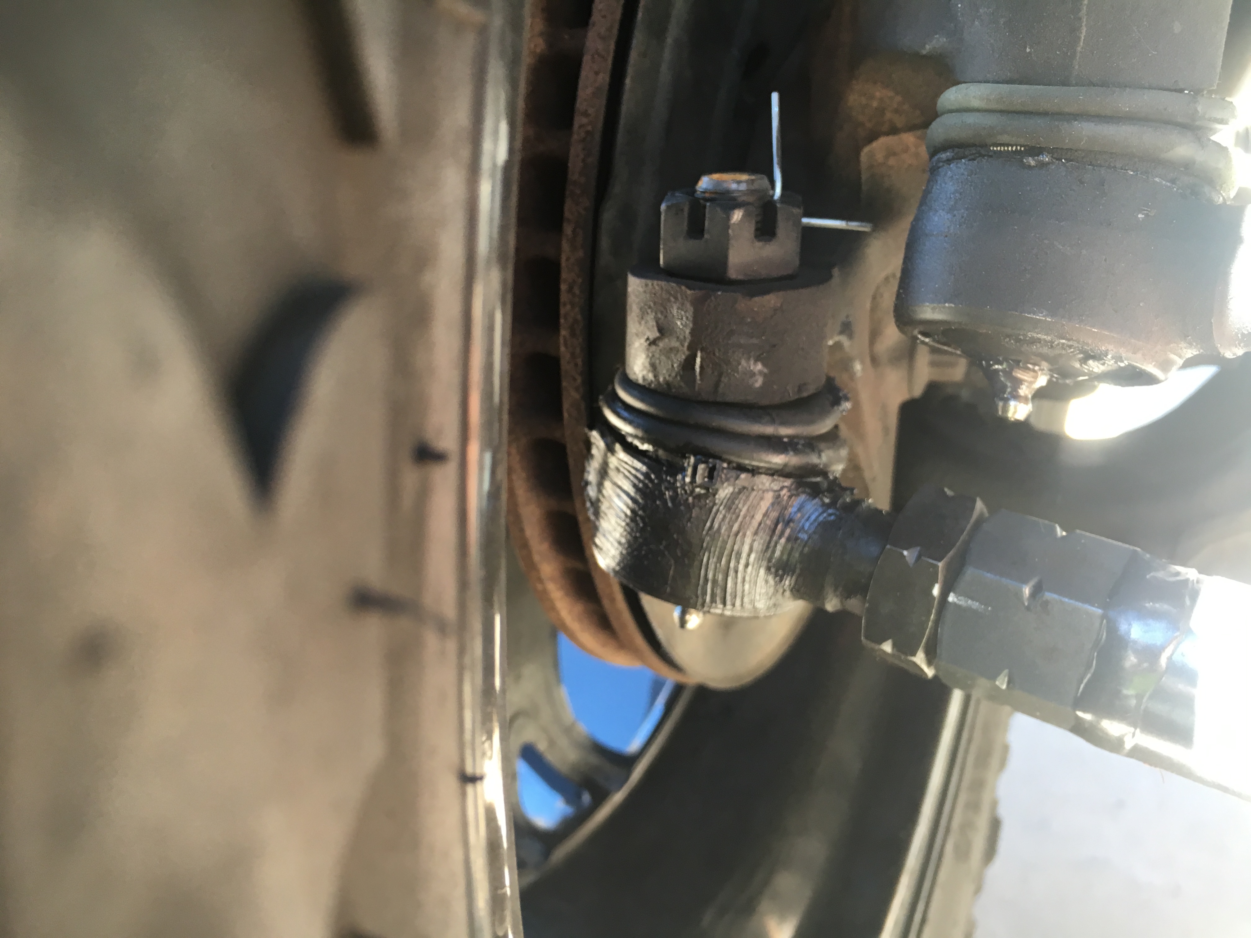

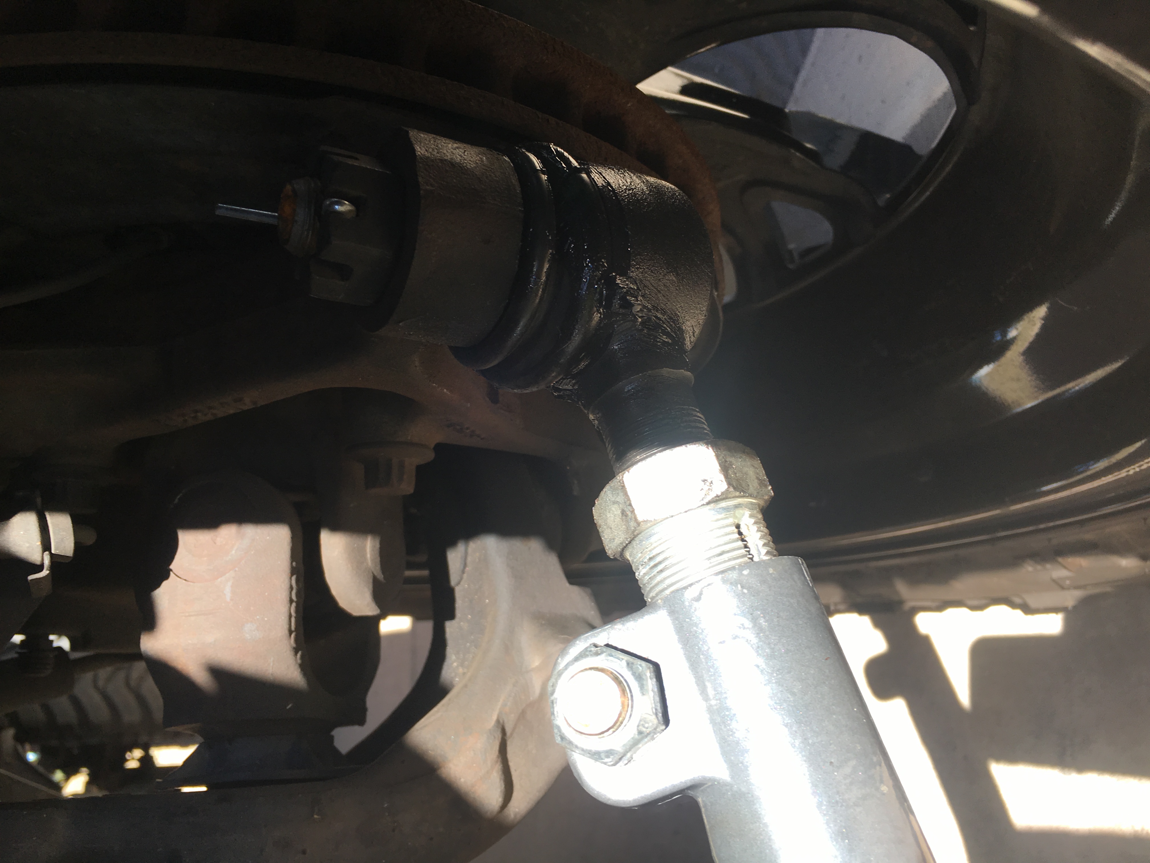

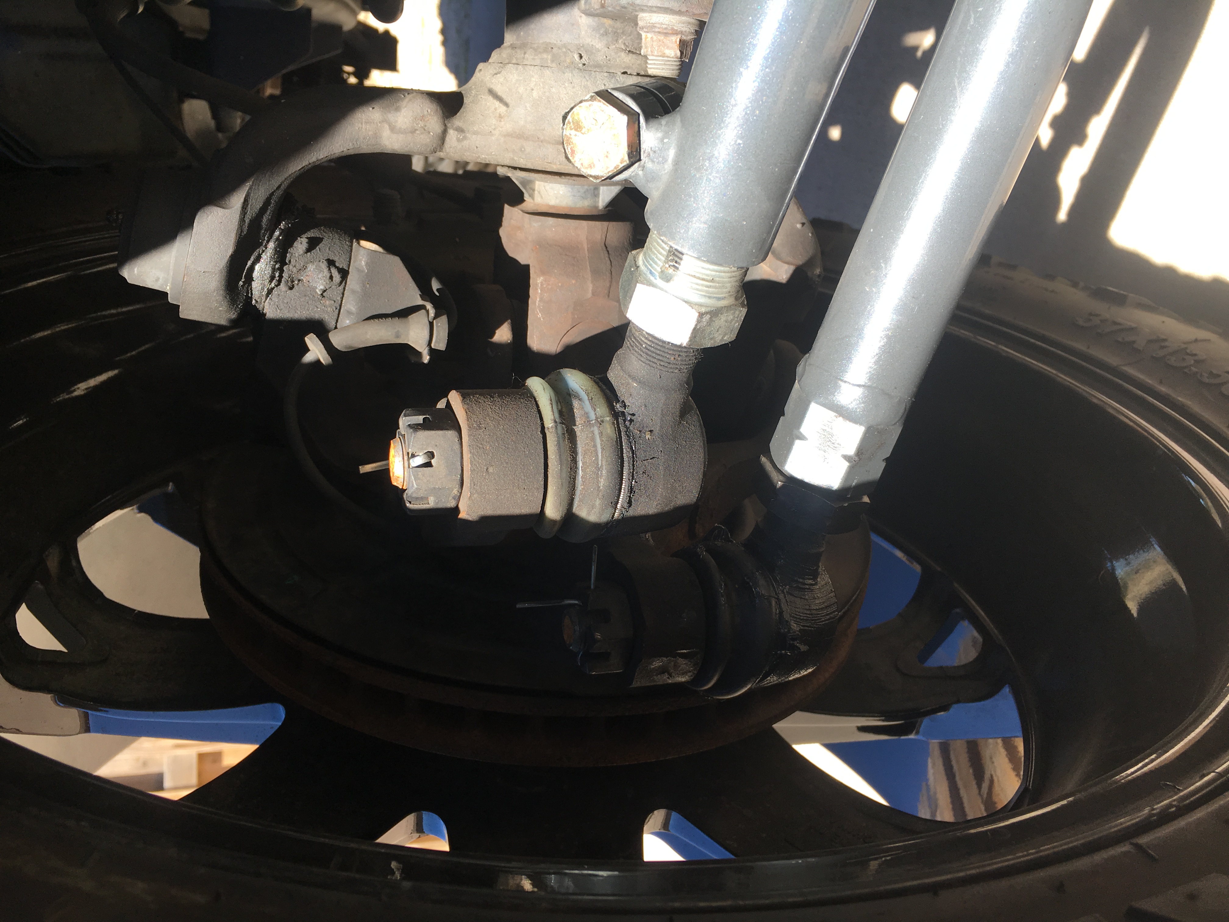

ID:	657680Click image for larger version
ID:	657681Click image for larger version
ID:	657682Click image for larger version
ID:	657683Click image for larger version
ID:	657684Click image for larger version
ID:	657685Click image for larger version
ID:	657686Click image for larger version
Old Sep 28, 2016 | 10:19 AM
JkHauler's Avatar
Posts: 408
From: Atlanta GA

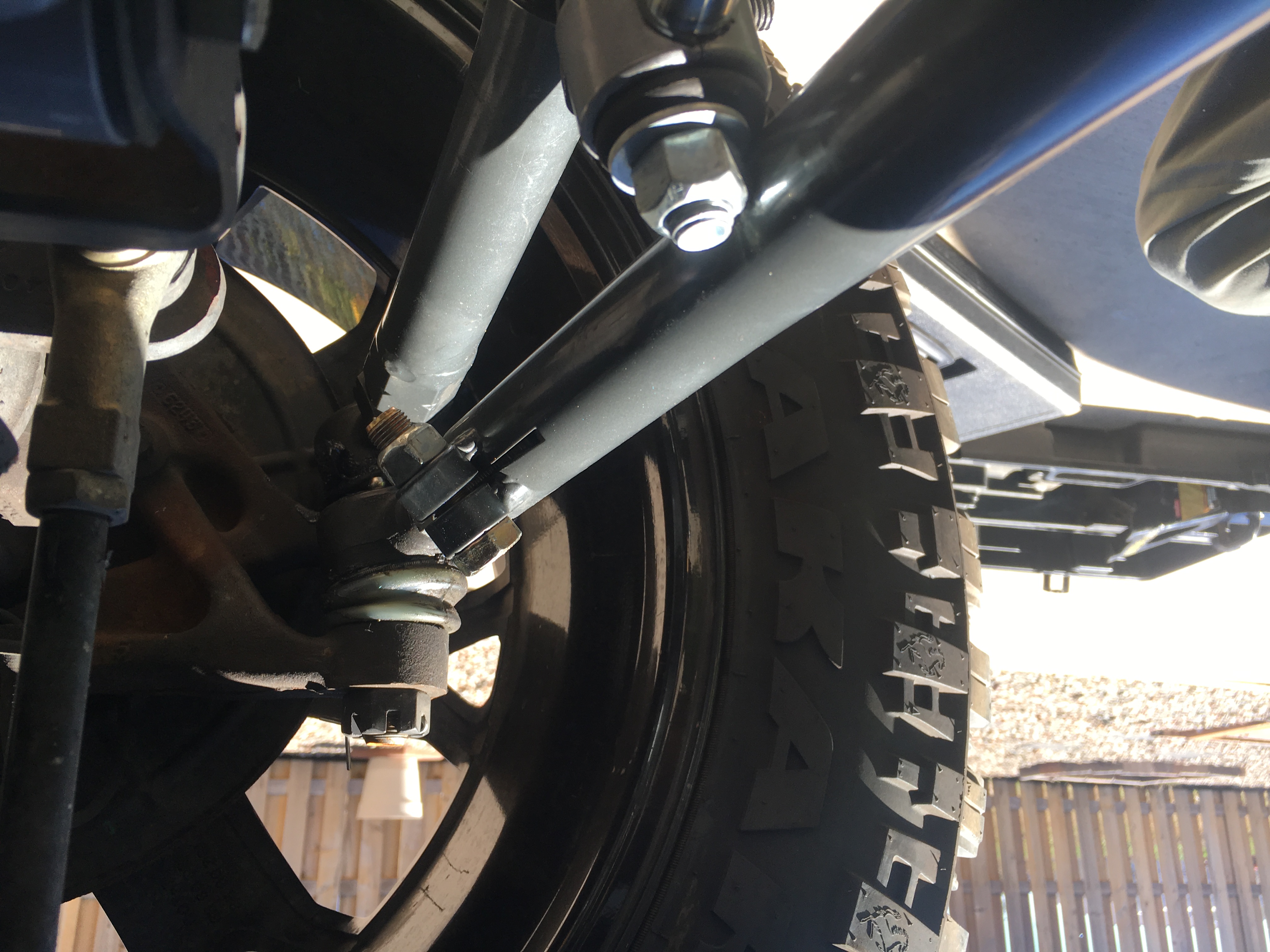

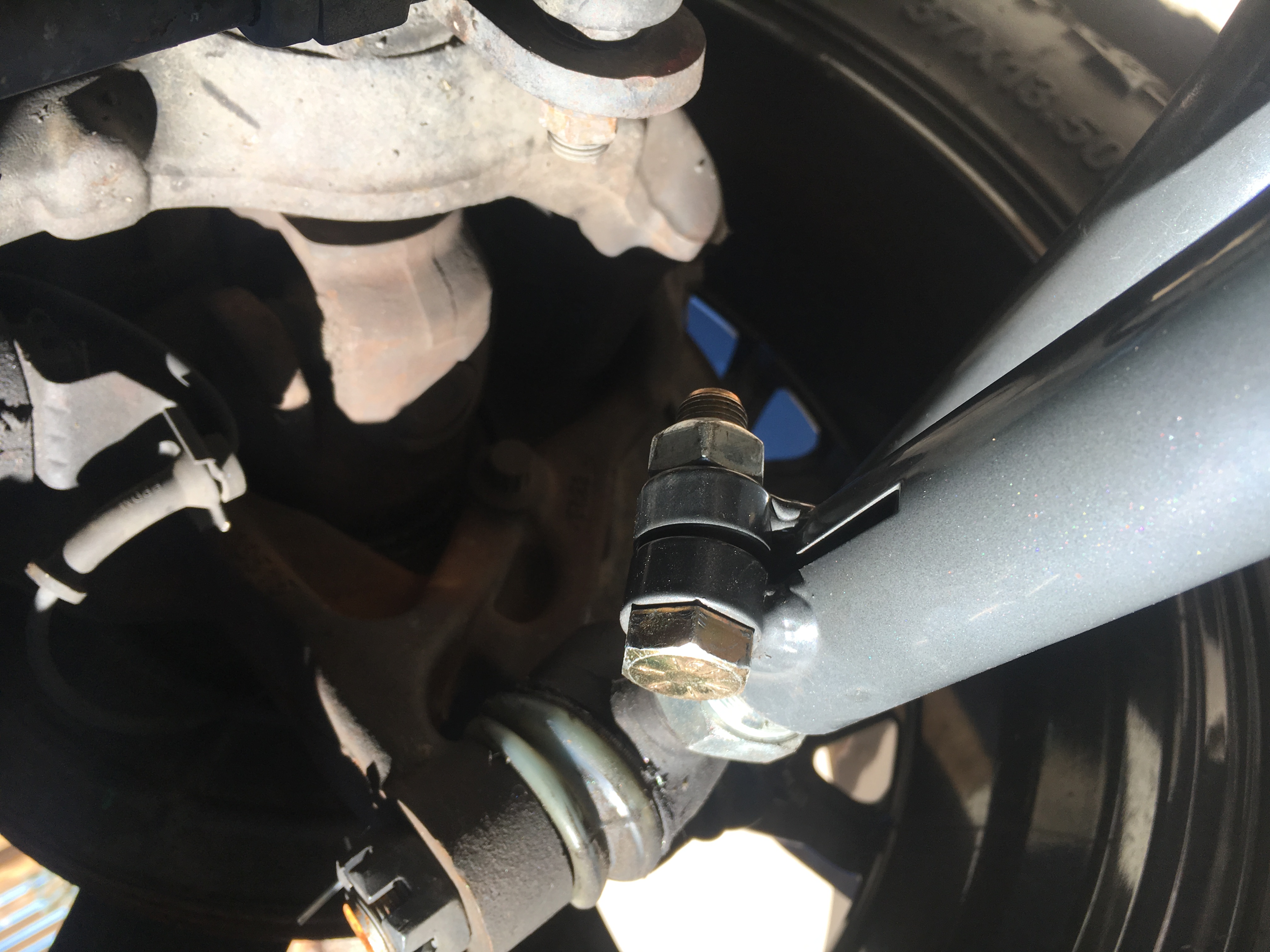

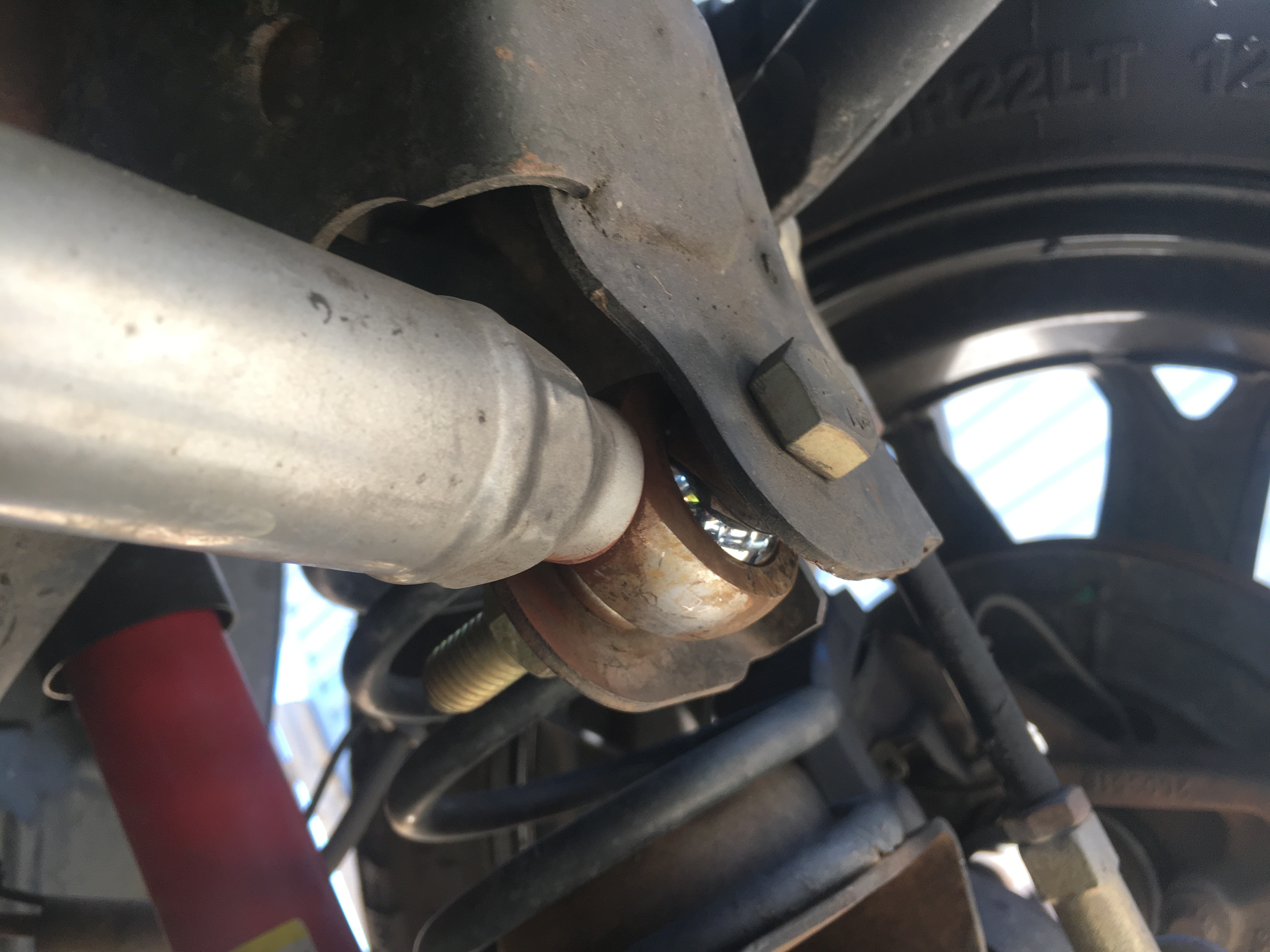

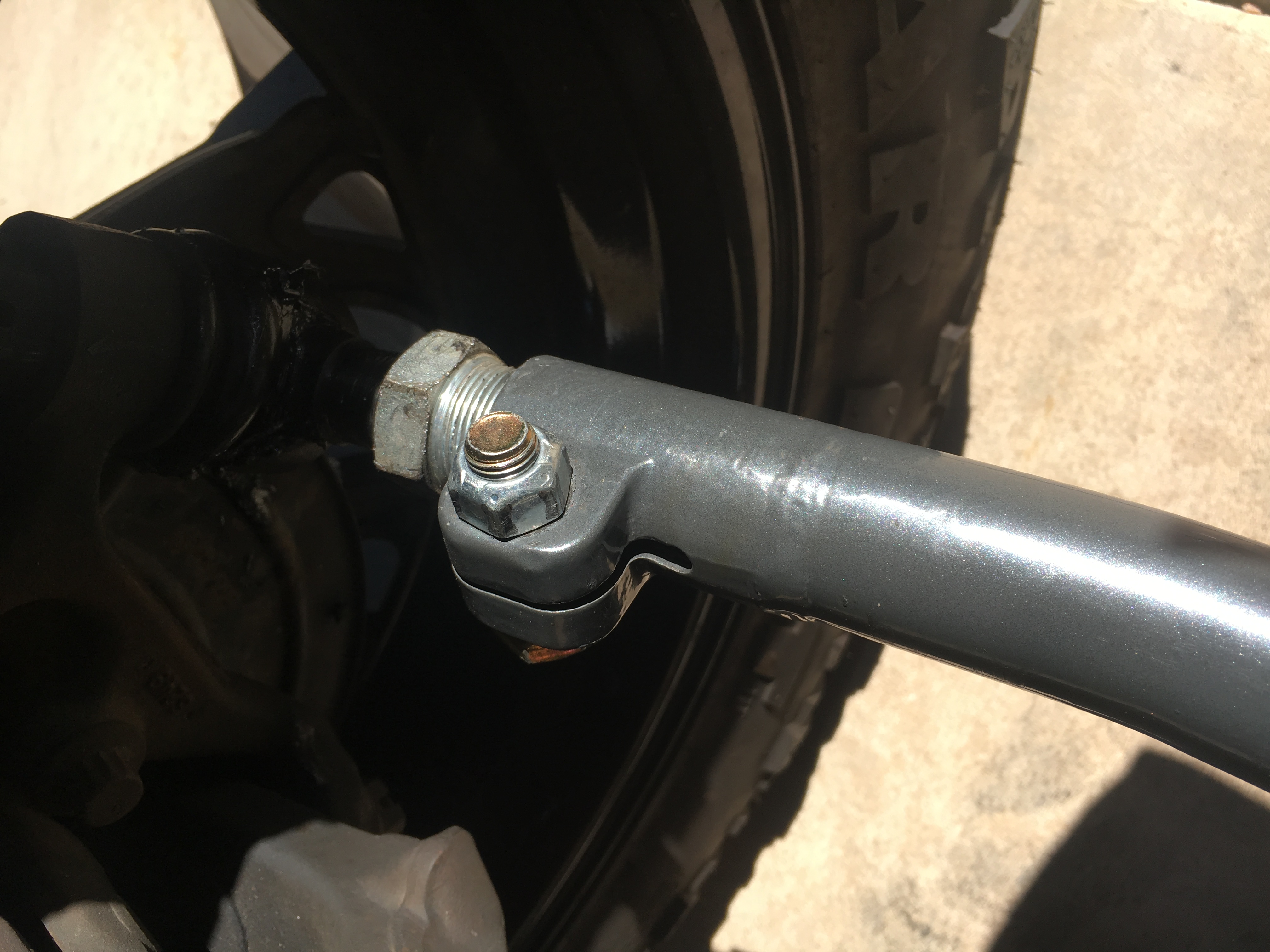

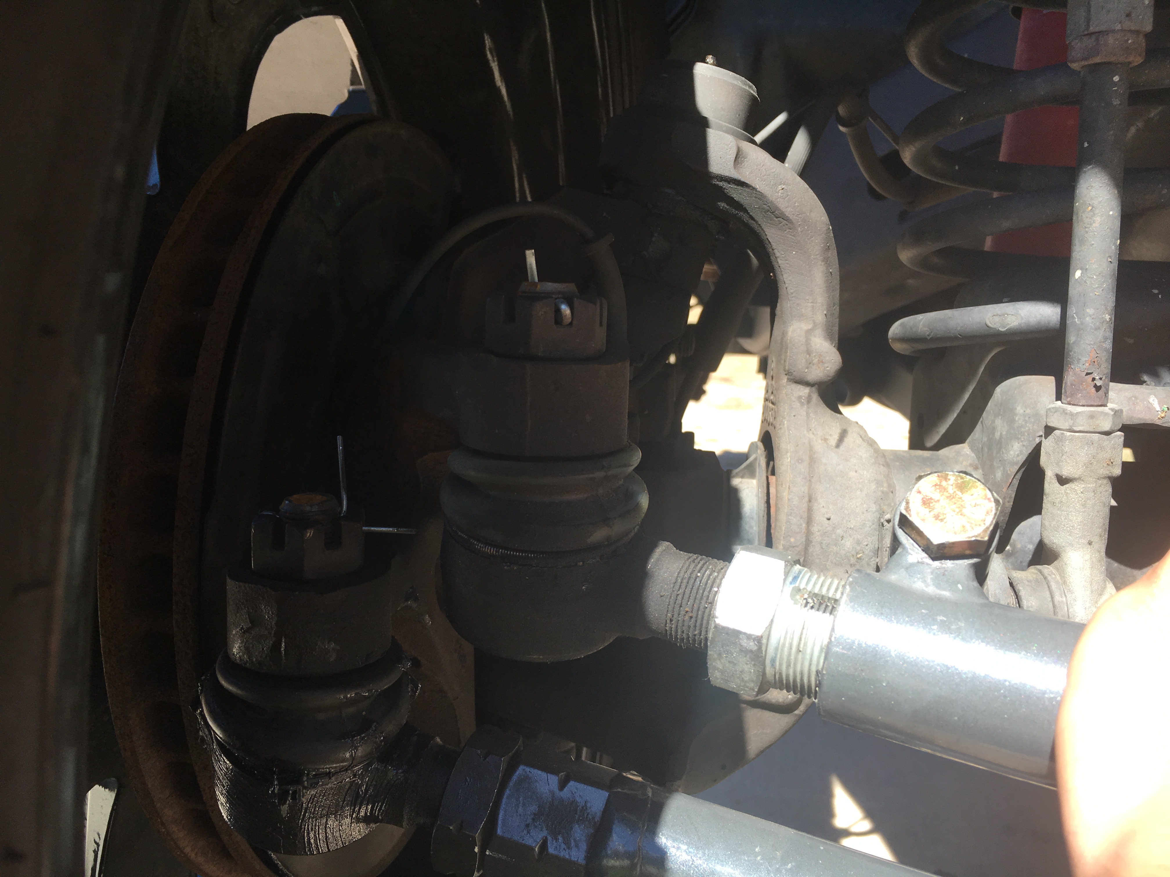

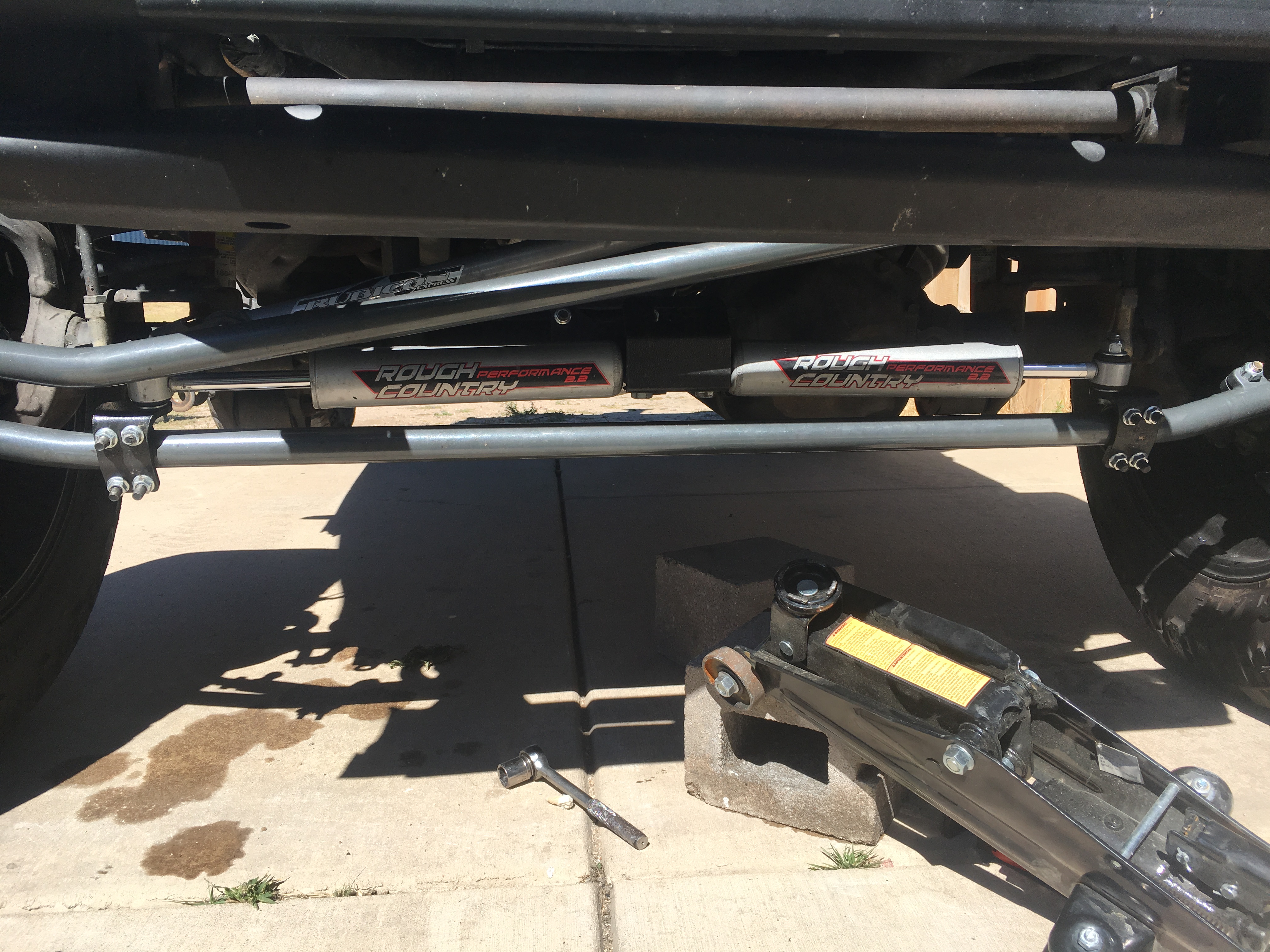

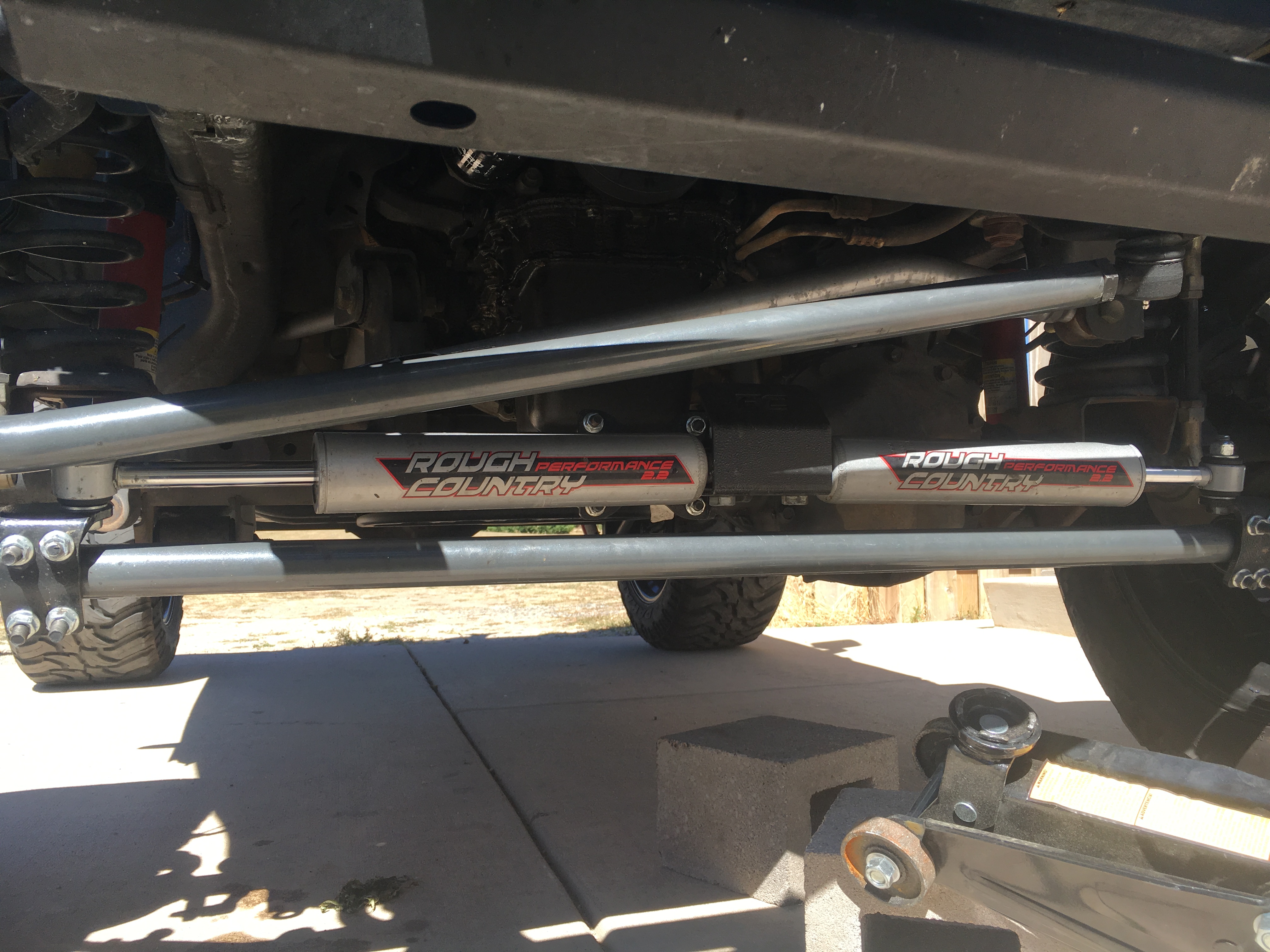

Off the bat, you need washers on that track bar bracket frame and axle side. Secondly, start checking torque values on the trackbar, tierod and the balljoints. Post up a picture of the front end so we can see the geometry of the trackbar to draglink. Those two pieces have to be as close to parallel as possible. If they're not thats where the relocation brackets come into play. Make sure every bolt on body side and frame side has a washer between the head of the bolt and the frame..

He's running a factory suspension kit. The red shocks are in the pictures. My guess is he is suffering from death wobble and purchased all of these parts to correct it, accidentally making it worse than it was before hand. Just my assumption at this point though.

DING DING DING exactly. The JK had a spring spacer lift on it when i bought it and the shocks are from a rubicon. Here is what happen. We were about to leave, decided to check the toe-in/tow-out alignment because this isn't a new issue and noticed it was off just a little bit and having just bought these tires i really don't want them ruined before it snows. So I lift the drivers side (usually lift both sides but didn't see any reason too since the adjustment bolt is only controlling the drivers side tire) and adjust the alignment to a 1/16 tow in. When i finish I noticed the tie rod on the passenger side had leveled out and even when the tie rod was pivoted all the way forward it was still pretty level although the drivers side would still was tilted all the way forward. But I figured this was a good thing as the geometry was better and the front end seemed tighter after i drove around. So I get back and decide to try and do the same thing with the drag link since it was pivoted/ tilted forward/down as well. I lift the passenger side and adjust the bolt on the drag link, tighten it all back up, go on a test drive and thats where everything starts to go down hill. I made a light left turn and the ESP light comes on then the steering wheel is out of alignment as well as the wheels. . So I drive back, attempt to realign then when i pull out of the driveway on a straight road the esp light comes back on. So now I'm here. I working on pics. iPhone decided to update itself so I'm waiting on that.
