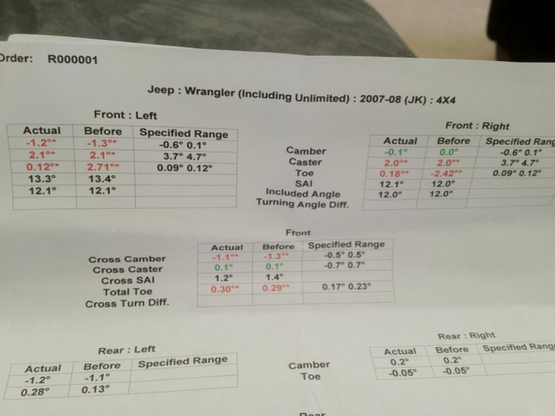

Just picked up a 07 jk with a 4"rough country lift on it. I would like some input as to what could be causing my front end to get loose when it is unloaded (ie. coming down a bump or slight incline) not really sure how to explain it other than its scary. I have dual rough country stabilizers and a jks adjustable trackbar. It used stock control arms (which I believe to be the problem but I'm new to the jk world ) here is a picture of the alignment paper from the precious owner. I interpret it as a caster problem by looking at the degrees but wanted some input before I take it somewhere or start throwing money at it.
Thanks for all the help this is my fifth jeep and only had xj's and a Cj
Matt

I'm thinking it would be caster considering you are using stock CA's on 4in of loft. You will want to get at least adjustable lower control arms for the front to fix it.. But wait until someone with more knowledge chimes in.

Thank you, will do. Suggestions for Lca's for a good price ?

I recommend rock crawler lca's. They are beefy as hell, fully rebuildable and not over priced.

Get rock krawler arms! Life time warranted. I just ordered some. 279 shipped
