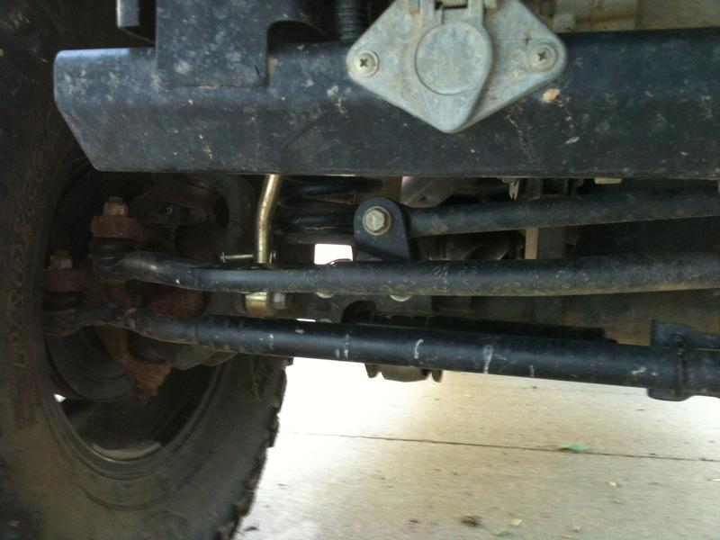

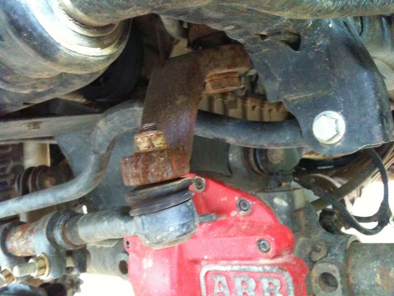

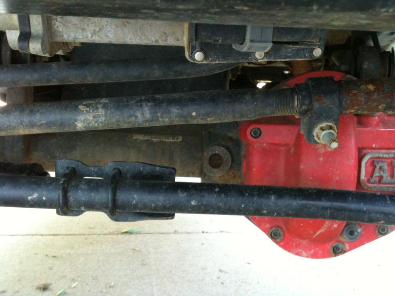

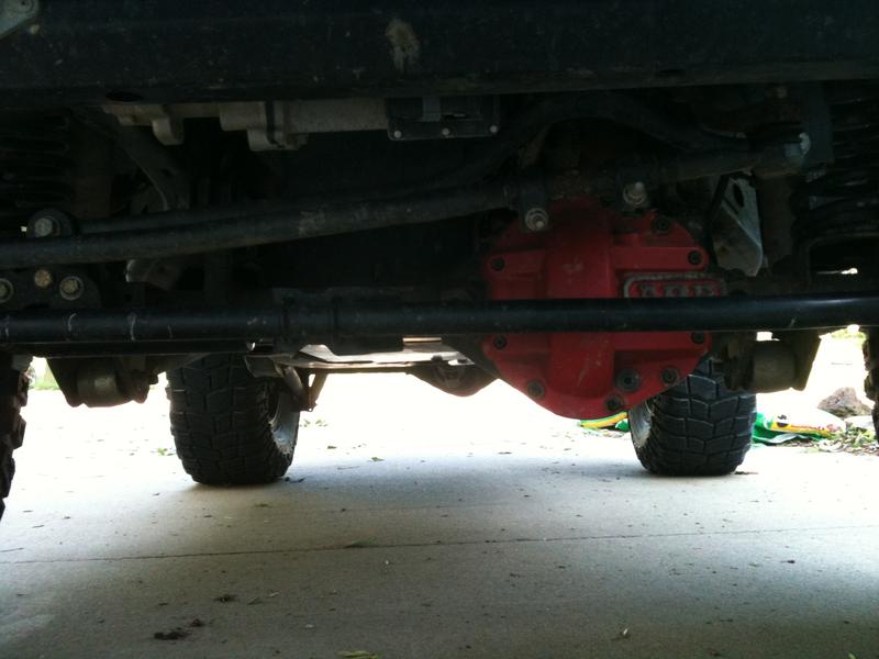

Here is a few pics I took this morning you guys asked for...

Based on these pics, you have a raised track bar at the axle end from the bracket from the lift kit and it appears you still have the stock pitman arm. So that tells me your steering geometry is not parallel and therefore, off. You need to either put an extended pitman arm on or remove the TB bracket and get an adjustable TB instead. I personally prefer the latter. I don't like the idea of a longer pitman arm. Also, with over 4" of lift, you might want to consider a flip kit such as Evo, TF, RK or Currie to really improve handling and eliminate bump steer.

Umm your nut on the sector shaft where the pitman attaches looks loose as shit. I can't really tell if your paralell or not in some of the pics, more light needed. Tighten up the big nut on the bottom of your box.
