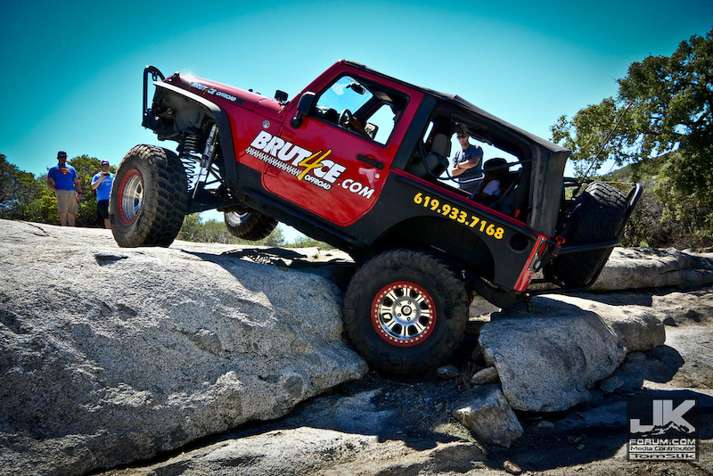

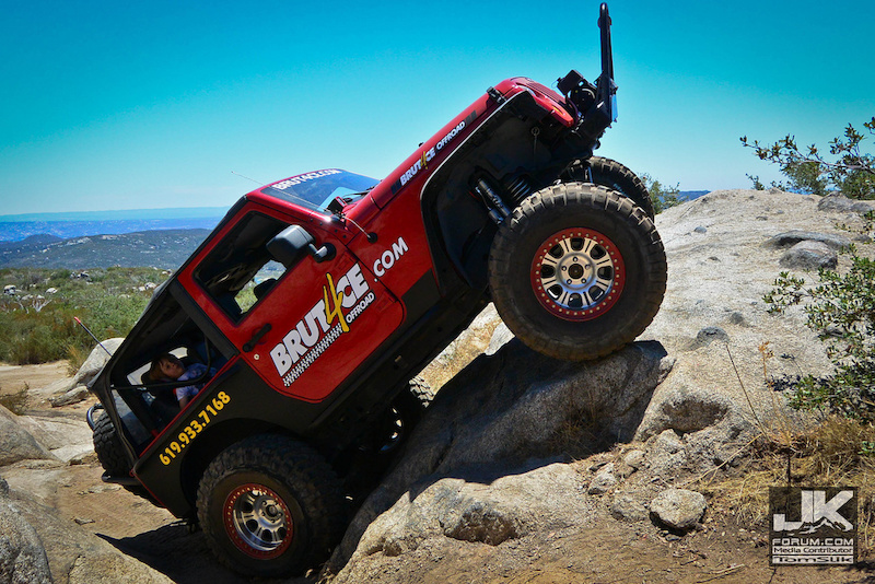

Rear for sire if your climbing anything etc the front unloads and gets light the rear loads up weight wise...
I had 3 spots wherever the front was too light and my rear locker wasn't working front was on...couldn't quite get it and front was spining and sliding sideways off the rocks had to back off before I flipped over sideways...made one by track standing it and when the front came back in contact with the ground I floored it...
Point is rear would have made em doable....
So my vote is REAR...
This one the front tires aren't on the ground quite yet, I made it.
This one I was coming back down the right front is still off I track standed over 2' here....
