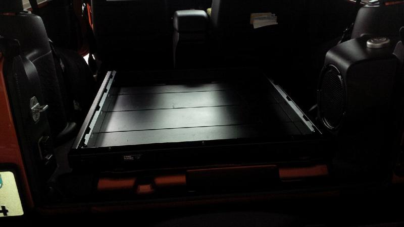

Just installed a Front Runner cargo slide in my JK.
They're actually designed to fit in the 4dr models. But with the rear seats removed and some minor modifications they fit the 2dr too.

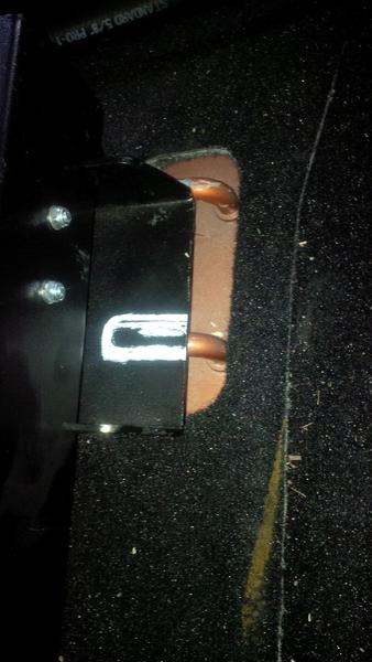

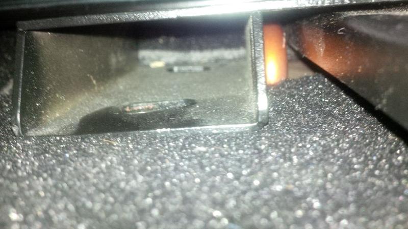

The front left bracket clears the rear seat bracket.

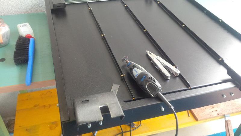

The front right bracket has to be modified.

Made a cut-out...

...to clear the front right rear seat bracket.

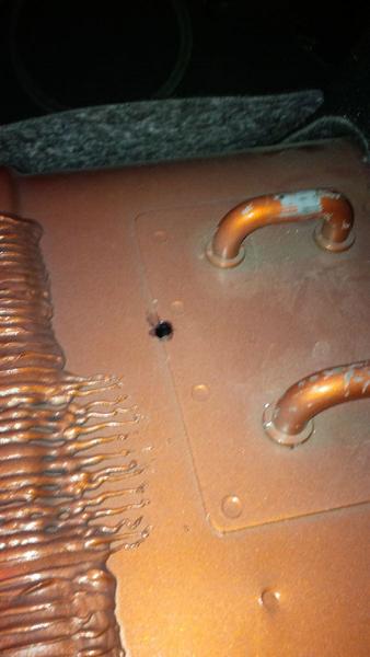

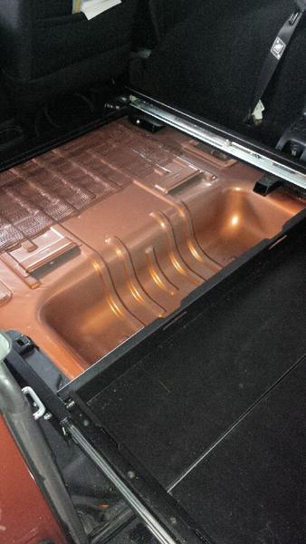

Then I had to drill a hole into the tub on the left side...

...and another one on the right side.
The slide is bolted to the tub through these holes and the factory cargo tie-downs in the rear of the cargo area.
The left hole is easily accessible from under the Jeep. The right hole sits over the rear end of the gas tank, but you still reach it with a wrench.

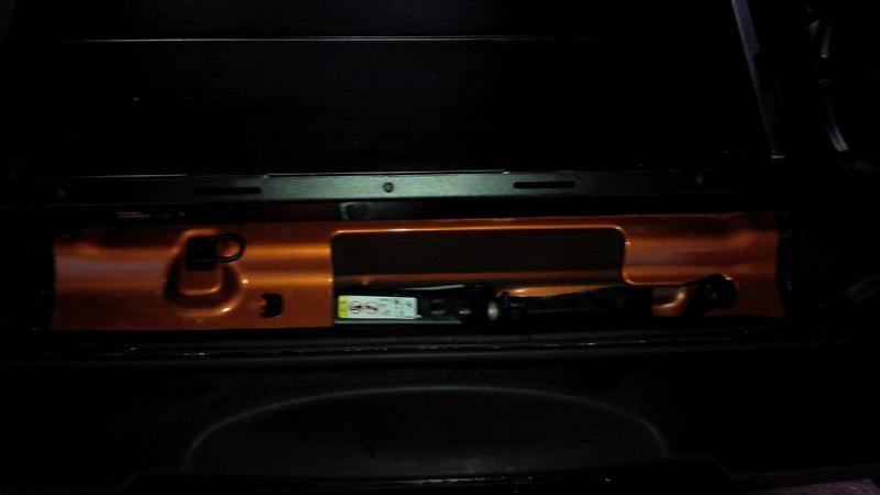

You can access the jack when the slide is closed.

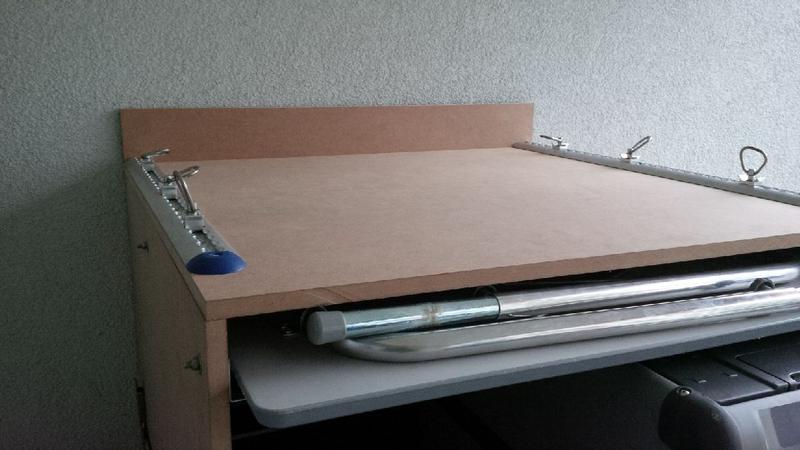

I have built a cargo deck that rests on the slider's frame.
This way I can stack my luggage and still be able to pull out the slider with the cooler and other stuff.

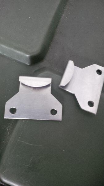

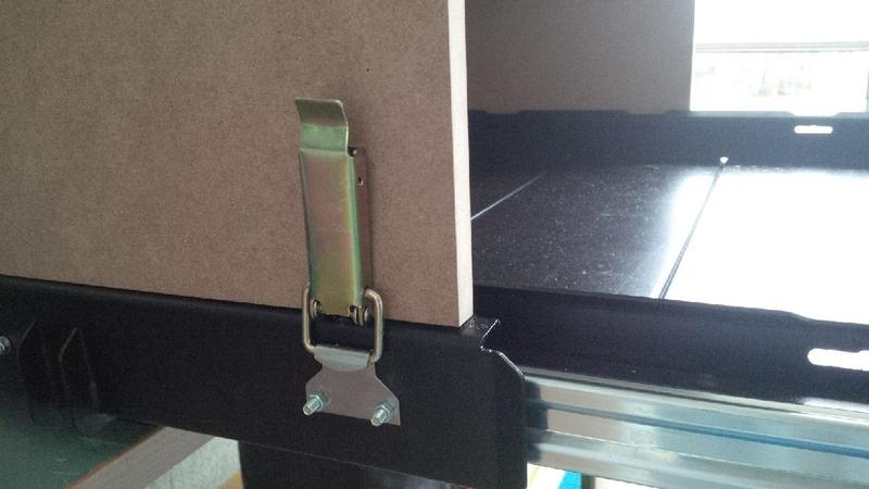

Custom hooks a friend made for me. I gave him the dimensions so the holes line up with the bolts that hold the slider inside the frame.

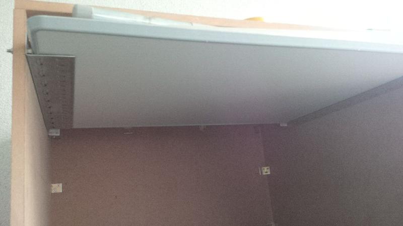

A place to store the camp table.

Tie-down rails on top.
