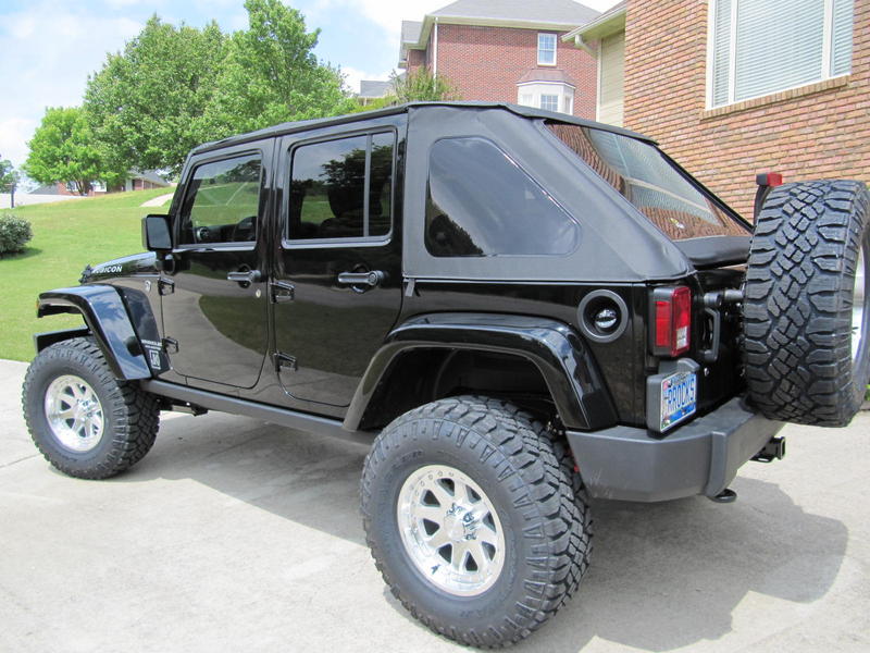

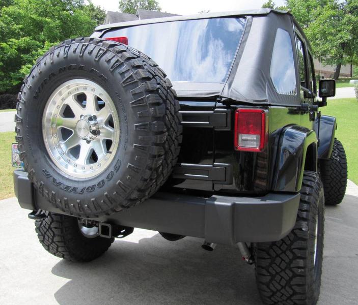

After 3 days of 80+ degrees stretching, almost there...
ID:	304524Click image for larger version
ID:	304525Click image for larger version
ID:	304526Click image for larger version
ID:	304527Click image for larger version
