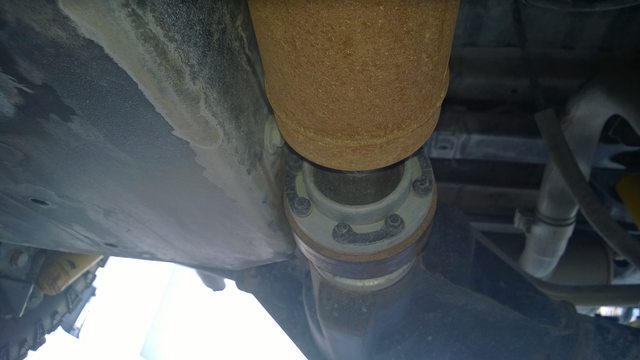

The primary reason I'm looking at the CRC link, is my drive shaft hits the gas tank and evap canister skid under full articulation. Stuffing the rear passenger wheel, causes the drive shaft to swing and hit the gas tank right at the pinion. And the other way, the rubber boot hits the factory skid plate on the evap canister. FT says that using the CRC link will completely eliminate the issues I'm having with the drive shaft.
The price is rather steep, but I'd be willing to pony up the cash if it's really worth it. Currently I've got the Metalcloak 2.5" Game Changer Lite lift. It comes with the Metalcloak rear track bar and relocation bracket. I'm thinking that because the bracket is so tall, it is causing some of the handling and drive shaft clearance issues I'm having.

An after market 1310 cv driveshaft would also eliminate the contact problems as they are a much smaller diameter.
Ah good call. I was worried that the "ears" on the shaft would hit the tank and get damaged, but they probably would be smaller.
