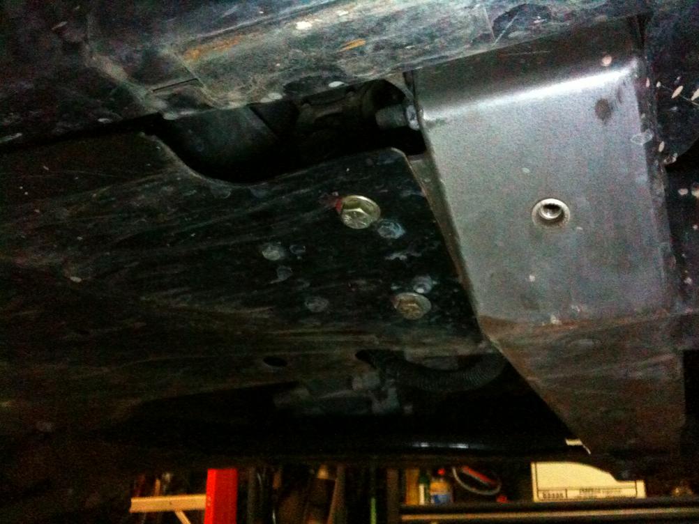

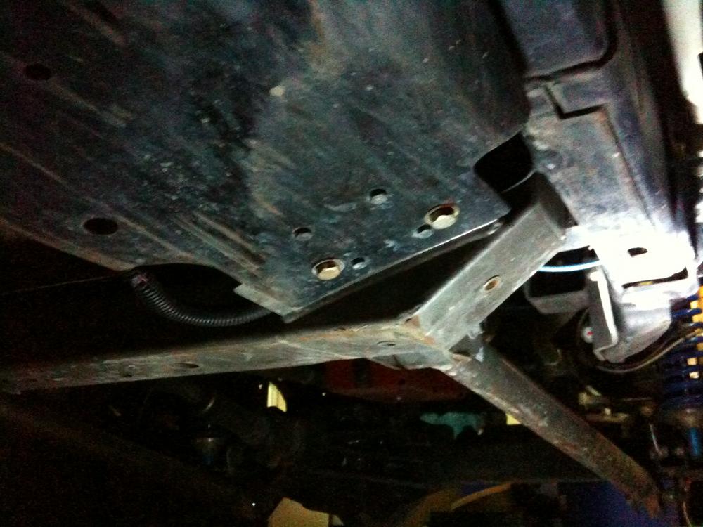

Originally Posted by stangjeeper
Do you have a pic of said cut? also a front shot of the new cross member would help. I tried searching and not alot comes up, The install thread had 63 pages of pics and I didnt see anything there either that had a good photo of it.
basically, the forward lip of the factory skid is attached to the cross member using 2 bolts. about 4" of that forward lip is cut off in a straight line and 2 new holes need to be drilled in the skid to bolt up to the cross member. i see no reason why you can't do this with what you have now. here are a couple of pics that i just took with my phone....
the 4 smaller bolts are for my air compressor and are not needed for your purposes. also, there is normally a skid plate that goes over this cross member but, you may not need it for your purposes.

Here is a pic of what was cut:

Thanks those photos help alot.I think Im going to have to look into other long arm kits as the the way the treks skid interlock together, Id have to cut away in so many places, Im afraid it weaken the mounts for the skids to the point of failure. But I need to do some more research first before I totally rule them out. ahh the fun just never ends....
