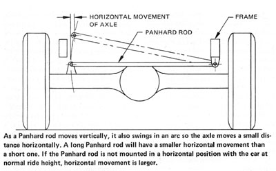

As WOL said it will return to a stock setting. In fact if you have a 4''lift, the angle made by the track bar and the drag link will be higher (compare to horizontal reference). Now if your axle is moving upward or downward, (if you do the math) the higher the angle is, the more the axle will have a horizontal displacement left or right.
If you use a bracket, it has the effect to lower the track bar angle (with a horizontal reference) then the displacement will be reduced. A figure that I found on the net explain this.
