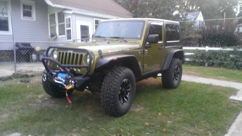

I have a 07'Rubicon 2 dr. 3.8, auto. I wanted to keep close to the factory ride height and feel, but still run 35/12.50/17 BFG KM2'S on Ultra Mavericks.. So I went with bushwacker flat flares and metalcloaks inner fender kit. Then I replaced the stock springs + shocks with 19/60's from a 4 dr unlimited Rubicon. This gave me about 1.5" of lift and still have the same nice factory ride.I have a genright trail series steel front bumper with a Warn 9.5 CTI with synthetic rope. Rear is a KO rock bumper with tire swing. Rocker protection is the bushwacker with the built in sill cover and factory rail delete with Garvin industries frame mounted rock rails with the extra tubes on the outside. I deleted my back seat also,(sold to a guy to put in his unlimited for third row seating, $250. for other more important jeep parts!) Performance wise I have AEM Brute Force CAI A superchips traildash and flows out Gibson SS dual outlet exhaust. All Led heads, tails, turns, side marks and interior lights. Still running a hard top but just scored a smoking deal on a new bestop trek top so hope to shed a little weight by changing that. The whole point is this is a similar build to what you are doing and I must say mine works just great! I haven't wheeled mine real hard yet ( I do have a couple trips planned in the next 2 months to do some harder wheeling).The one thing I want to change about mine is the gears, the traildash has helped but lower gearing would be much better with an auto for sure.

Thanks XJay for the reply! Looks like you got a decent idea of where I'm going with this thing. Gotta say, I really like the low stance of your jeep with the 35's. Notice any big differences in ride/gas mileage/handling? Stock shocks?
