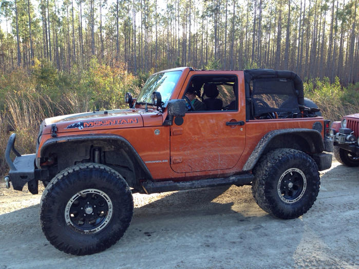

I'm running 35s with 2.5 in of life and flat flares. I like the look. 37s on 3.5 will look great. The 44 will give you some strength up front.

Good luck. I will say that. To me 35s are plenty unless you're really doing some heavy wheeling. I run mine aggressively in the woods. But I'm a Florida boy. Mud holes and dry lakes etc. you can start breaking things if ya go to big. Knowing that. Have fun and enjoy.
