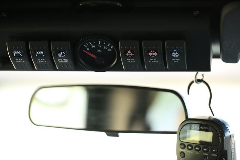

Originally Posted by ronjenx
... Or, you can install an adapter between the oil filter pad and the oil filter. A sender will screw into the adapter.
That's what I did.
http://www.glowshiftdirect.com/Oil-Filter-Sandwich-Adapters.aspx
Mounted VDO gauge, which is a very close match to stock gauges, in the sPOD controller. It's a very tight fit (due to depth of the gauge), but worked out very nicely ...
Name:	Jeep Work, Sep 13, 5_9826, Engine Fan Switch.jpg

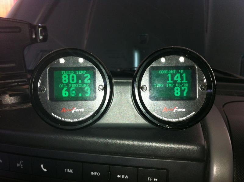

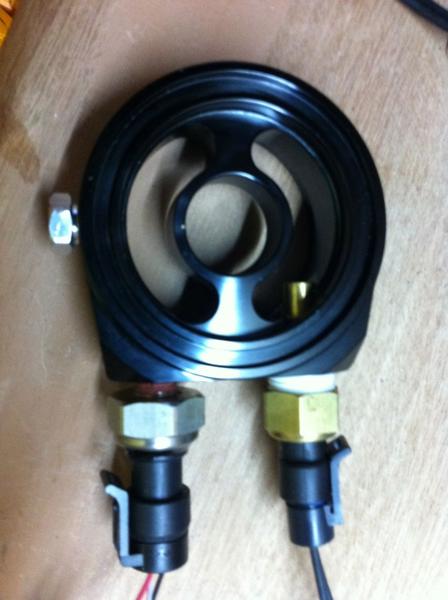

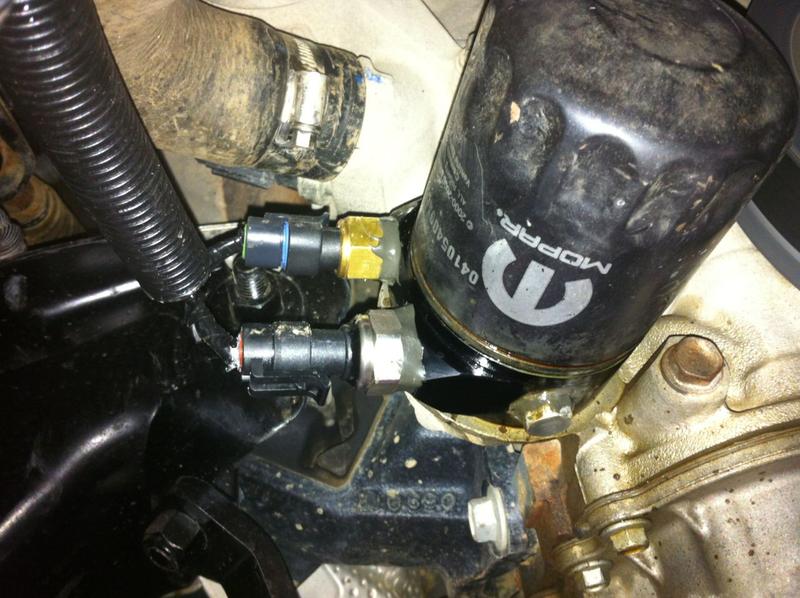

I have Aeroforce gauges installed with a sandwich plate behind the oil filter.
Hi Mark D
Cheers,
Mark
ID:	516099Click image for larger version
ID:	516100Click image for larger version
Name:	Sandwich adaptor.jpg

The areoforce gauge is sweet but pricey. How does the analog display wire up? Just a single line from the sandwich plate to the guage? What kind of wiring is neeeded to connect the display to the sensor?
Old Dec 11, 2013 | 07:31 AM
Mark Doiron's Avatar
Posts: 14,800
Likes: 374
From: Midwest City, OK
A single wire, yes. The sandwich plate doesn't include the sensor. It has ports that can be used to connect up whatever you want: Sensors, coolers, etc. The sensors often have two wires, but the second is for the warning light (idiot light), which I still depend on the stock system for. So, just a single wire to the sensor up to the gauge, then a wire from the gauge to switched power, and a ground wire. The sensor ground is through the block (if you don't put Teflon tape on it like I did, LOL).
