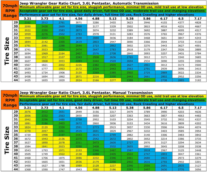

Motor and transmission plays a role - but here is a good chart most go by.

There are about a thousand other 'what gears should I get?' threads for you to read through, those charts are just a starting reference point. Then you look at the engine/trans combo. 2door or 4door. Elevation and terrain (flat roads at sea level or constant hills/mountains at 6 or 8 or 10 thousand feet). A lot of high speed freeway or mostly in town or offroad. Build/overall weight. Actual tire height, since that can vary quite a bit by mfg/psi. And then just plain ole personal opinion.
But for me, 5.38 is the only choice for 37's.
