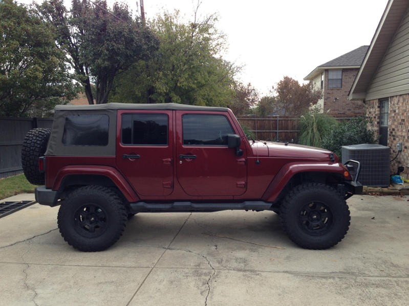

Love my 4.88's with 35's. can cruise at 70. Combined with the superchips it drives better than before
